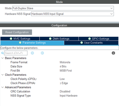

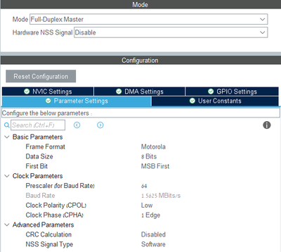

I am using 2 boards with SPI communication between them: STM32F412G-DISCO as the master, NUCLEO-G071RB as the slave. The MOSI direction works well, but the MISO direction doesn't works. Monitoring the MISO line via. oscilloscope shows that there is no communication in this line, also it is expected to be.
The boards configuration:

3. using NSS hardware on receiver, but nss-software on transmitter...might create problem, if you dont do in software, what other chip spi-hardware expects. Try setting both to hardware nss. And use TransmitReceive on both sides.
I tried your suggestion, now the slave indicates that the Busy flag is set, and the HAL_SPI_TxRxCpltCallback doesn't called back.
