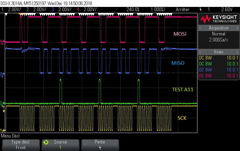

}and I can see that the RXNE flag is set only after the 3rd TX:
Why must I send 3 bytes before having 1 RX when the SPI is configured as 8 bit data width?
2018-12-20 12:01 AM
issue was linked to the FIFO Threshold. It is ok now.
