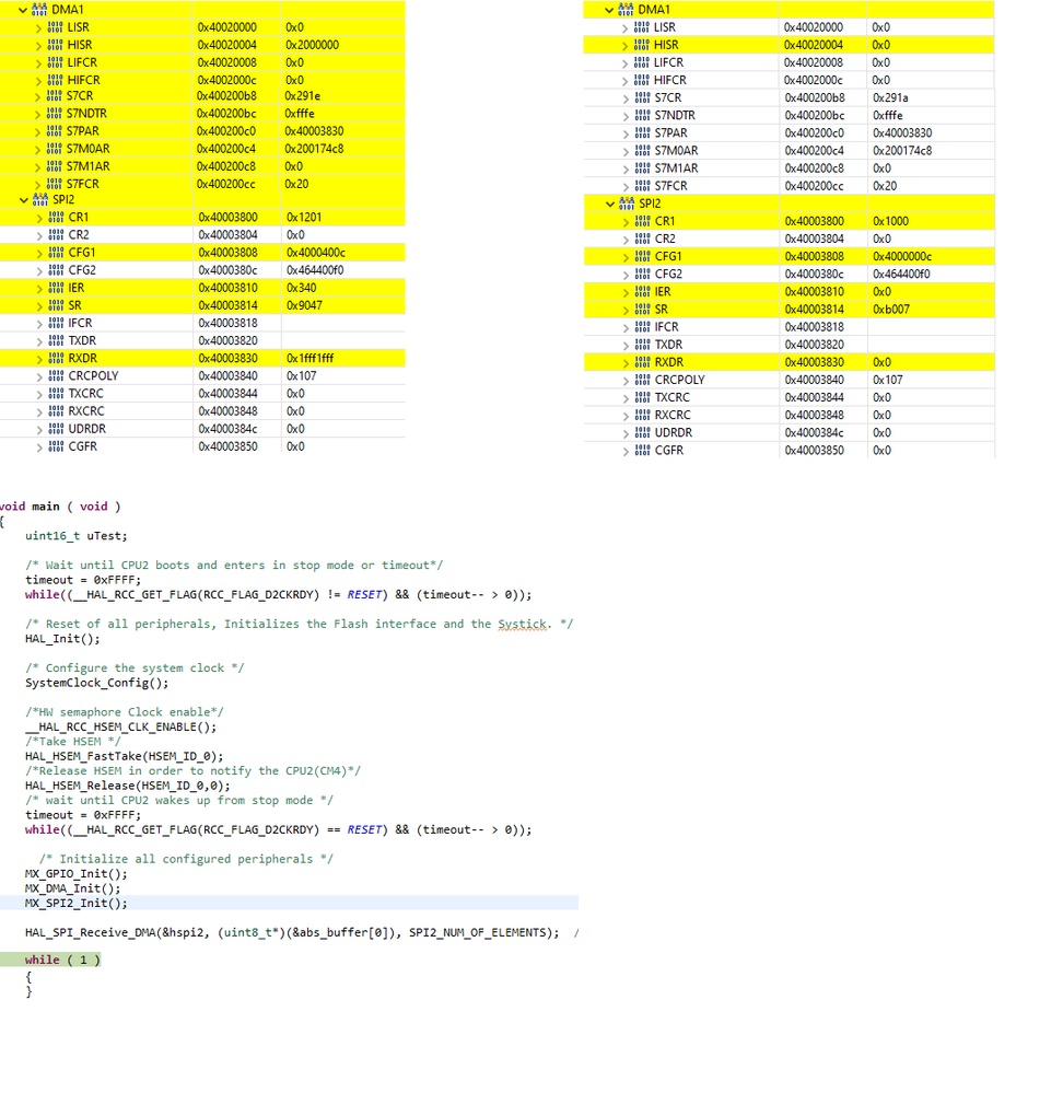

I've been trying various different DMA/SPI settings, but no luck, something stops the DMA. Not sure if it's related but *VERY* frequently, whenever I'd restart the debugger, the CPU would hang on:
SystemClock_Config():
while(!__HAL_PWR_GET_FLAG(PWR_FLAG_VOSRDY)) {}I ended up commenting out the while loop, and haven't noticed anything unusual (aside of course from the SPI/DMA issue).
The image shows a capture of the registers while SCLK is active, which only works when I step over the HAL_SPI_Receive_DMA call..
as well as a register capture taken immediately after (Resume+Pause). The SCLK stops as soon as I resume.
BTW, this is an STM32H745
2020-11-02 2:12 PM
There's transfer error set in the status word of DMA, and suspicious value of NDTR.
Make sure the used memory is accessible by the DMA and used address is properly aligned.
I don't use the 'H7.
