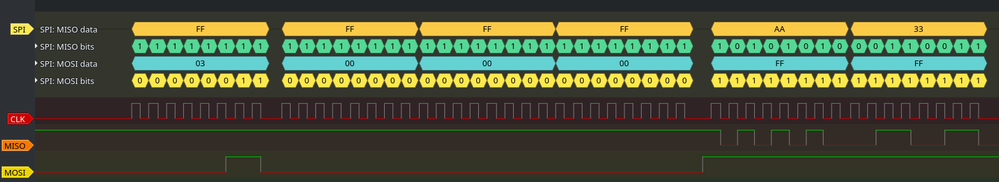

The logic analyser shows the expected values from a 23LC1024 SPI memory slave :
The two last bytes are AA33 as expected.
