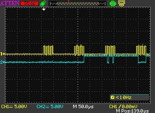

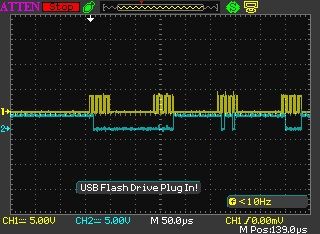

Well I took your advice and I think the problem is in my FPGA code.
Checking for RXNE first did not fix the problem so I attached the scope and found the following. When I reset the STM32 it must toggle the chip select pin a few times and properly reset the send registers in the FPGA, after the reset the scope send looks good and the second sent looks like the data that I am getting on the STM32. Here it is after the reset:2013-08-17 8:42 AM
I added this to the beginning of the send / receive function at it seems to have ''fixed'' the problem
GPIO_WriteBit(GPIOC, GPIO_Pin_6, 0); // Set SSEL pin low for(delay=0; delay<20; delay++); GPIO_WriteBit(GPIOC, GPIO_Pin_6, 1); // Set SSEL pin high for(delay=0; delay<20; delay++); So it looks like I need to do a proper code fix on the FPGA Thanks for the help DaveWe’re moving the ST Community to a new platform to give you a better and more reliable community experience.
