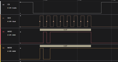

Here you can see the normal, successful, SPI read. I place a byte in the DR and we can clearly see it clocking the read command
When the read operation fails, I see the following:
You can clearly see that the first five or six bits get clocked, but then the operation just seems to pause for round about 175us (plus or minus a few us) before starting up again and finishing the operation.
