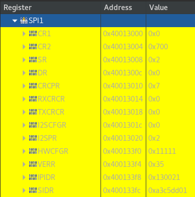

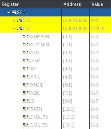

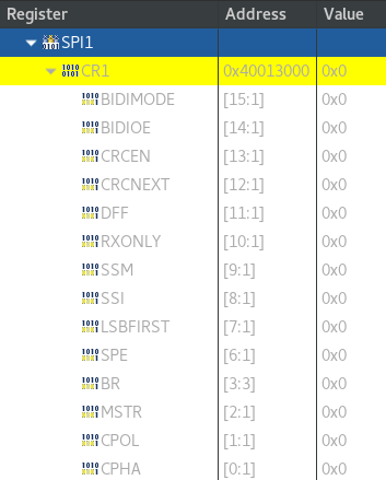

Read out and check/post the SPI registers content.
2021-03-09 12:29 AM
Here are the registers after initialization. Looks fine to me.
Edit: Ohh sorry, that was just the initialization, before enabling it. This will also set the SPE bit in CR1, everything else stays the same.
