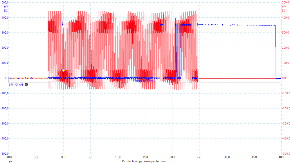

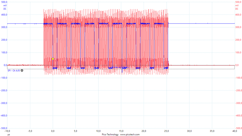

Ok, another thing I noticed: if I watch the MISO signal with the scope, everything is ok. But when I pause the debugger, I see this 'strange' data pattern on the MISO line. So what I could imagine is that the slave has an error with the HAL_SPI_TransmitReceive_DMA function at one point during the runtime and does not recover. So, anyone an idea what the correct behaviour is, if you get a a status != HAL_NOK from HAL_SPI_TransmitReceive_DMA?

Normal behaviour
Behaviour during debugger paused:

Sorry, so the slave sends data to the master during transmit/receive. So I’m is a framecounter, some measurement values followed by a checksum. And this it what I absolutely don‘t understand: I never send this kind of data seen in the scope. So it seems that it it not the last frame I have sent before pausing the debugger.
