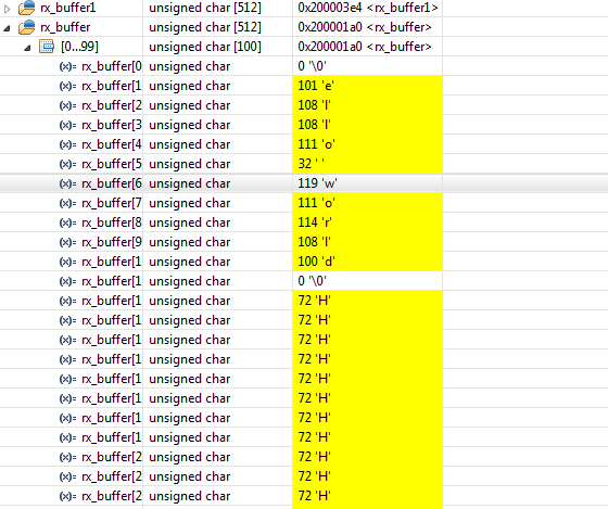

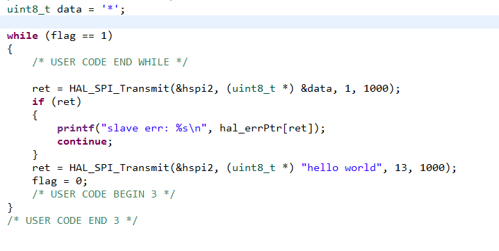

Here I attached some screen shorts can you please help me to solve this problem?
And i have doubt why i received 1st byte in last and received it n times?
code flow....
received buffer data...
