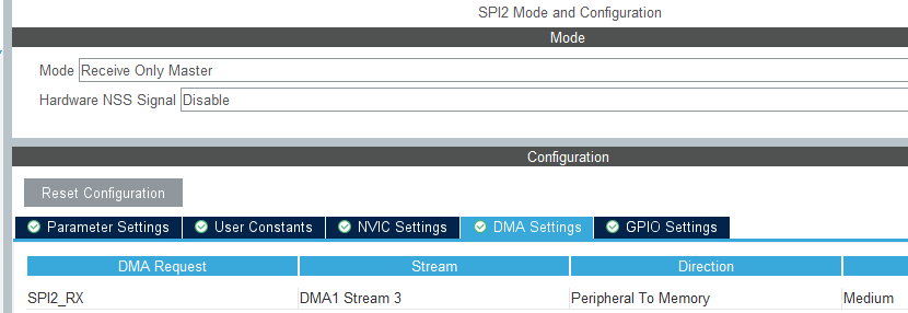

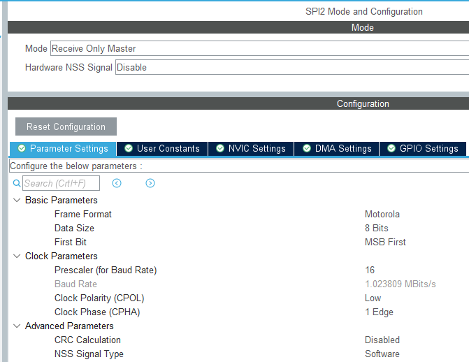

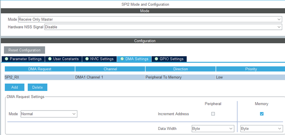

}I am using CubeMX to setup F407 as shown below.
F407 parameter setting
F407 DMA setting

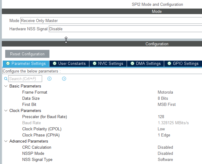

I used the same on G474 as shown below.
G474 parameter setting
G474 DMA setting
Basically everything is almost the same.

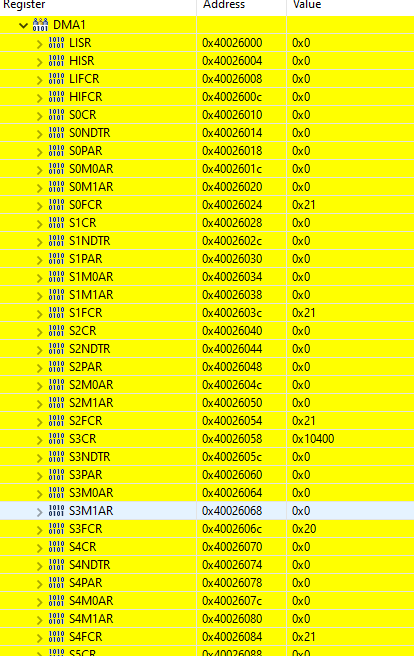

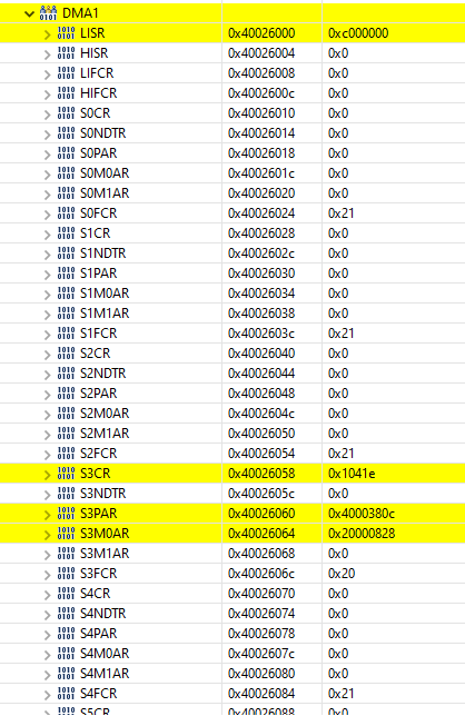

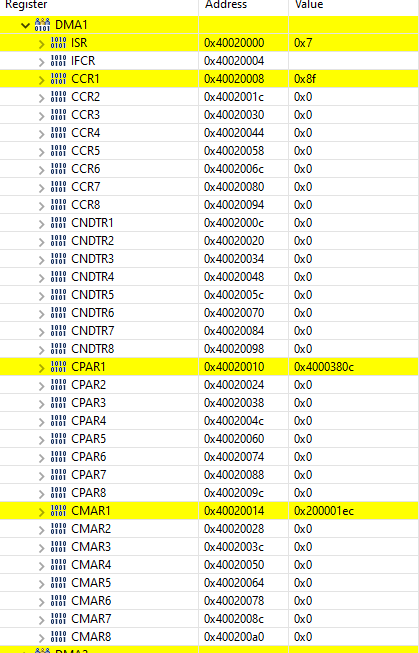

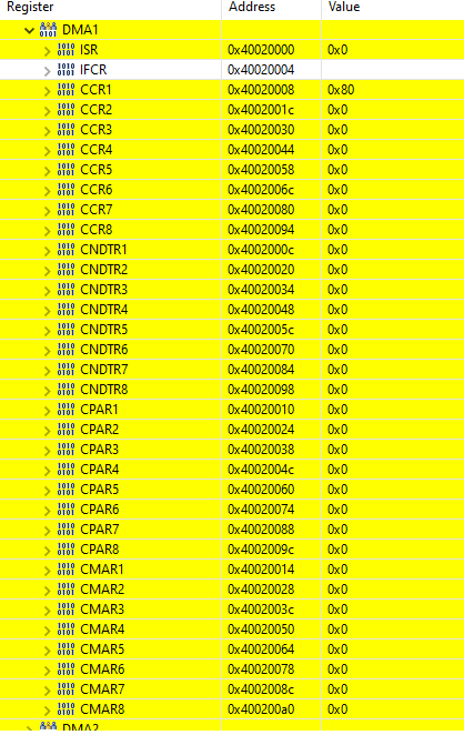

When debug, I checked the before and after HAL_SPI_Receive_DMA() of both SPI and DMA register data as shown below.
G474 DMA1 before HAL_SPI_Receive_DMA()
G474 DMA1 after HAL_SPI_Receive_DMA()
G474 SPI2 before HAL_SPI_Receive_DMA()
G474 SPI2 after HAL_SPI_Receive_DMA()
F407 DMA1 before HAL_SPI_Receive_DMA()
F407 DMA1 after HAL_SPI_Receive_DMA()
Any idea what did I miss? I am using CubeIDE 1.7.0 and STM32Cube_FW_F4_V1.26.2 and STM32Cube_FW_G4_V1.4.0.
Here are the IOC files for both devices.
