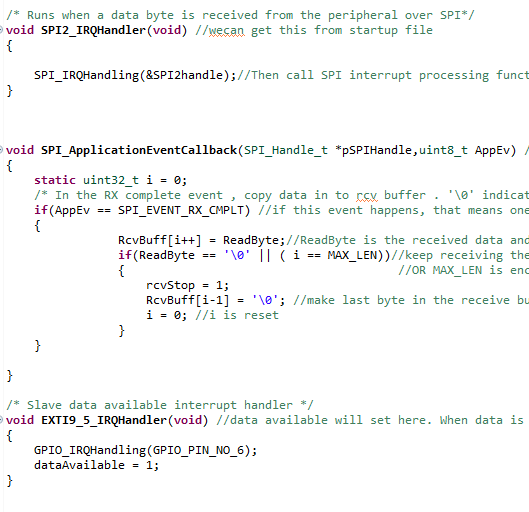

After the message is entered, the arduino will make D8 goes LOW to trigger the PB6(stm32) interrupt at EXTI9_5_IRQHandler.
After interrupt is triggered, the program will execute the SPI_SendDataIT(&SPI2handle,&dummy,1) to fetch the data from slave.
Then, (SPI_ReceiveDataIT(&SPI2handle,&ReadByte,1) will execute.
during this, whenever one byte of data available in the master, the RXNE interrupt will trigger. So, SPI2_IRQHandler function will execute.

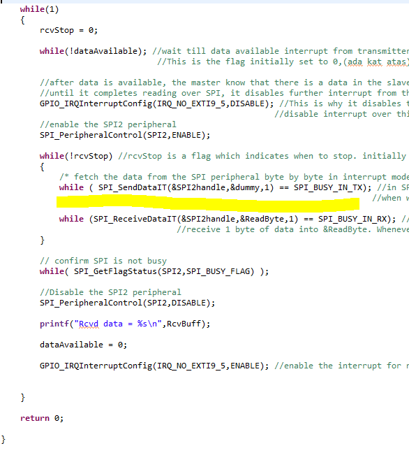

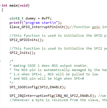

Here is my main code:
Before this, during normal SPI transaction, every data that I need to send, I need to read it. But, in this program Im not sure how I am going to do it. There is a yellow line that I highlighted in the program.

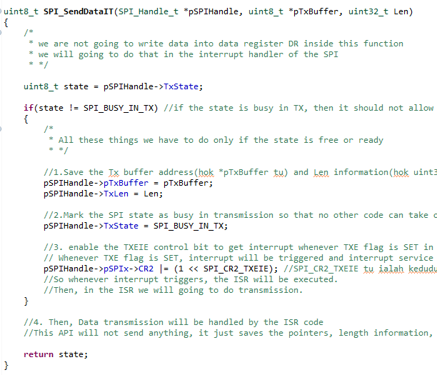

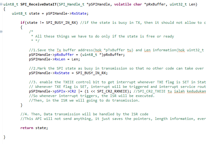

Here is my SPI send data interrupt code:

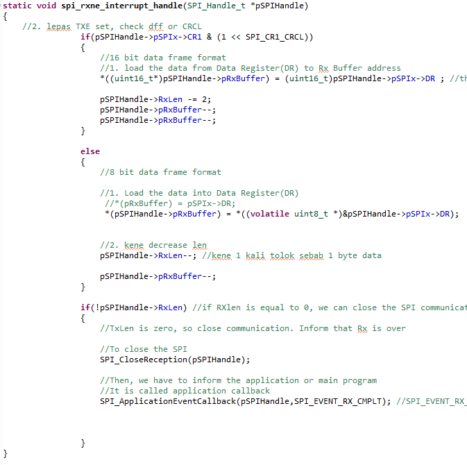

Here is my SPI Receive data interrupt code:

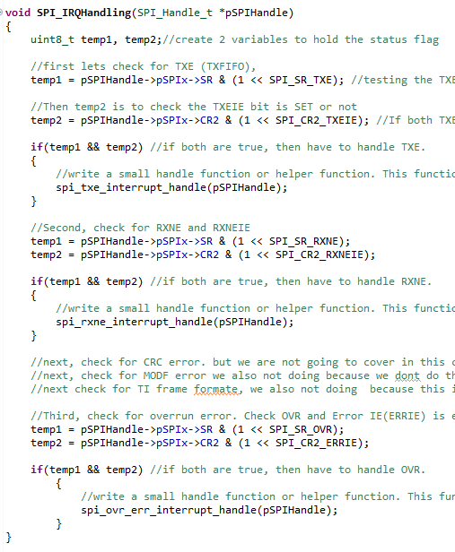

Here is my code for SPI IRQHandling:

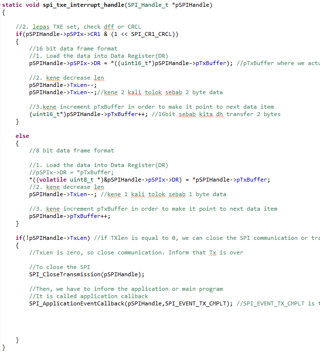

Inside the SPI IRQhandling, there is 2 helper functions that will store the data:
spi_txe_interrupt_handle:
spi_rxne_interrupt_handle

> while(!(SPSR & (1<<SPIF)));
You want (SPIx->SR & SPIF) instead. This error is pervasive in your code.
Posting code instead of pictures of code is much better.
