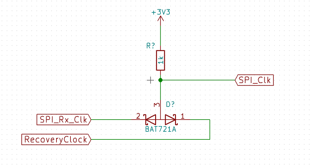

The bus has to be working in a noise environment, I cannot mitigate that. Additionally I know, when the spikes on the clock line happen, so all I need to do (at least that's what I think), is to flush the RCV FIFO or to reset the SPI peripheral after this moment in time.
I call the HAL_SPI_TransmitReceive_IT(&hspi2, (uint8_t *) tx_status, (uint8_t *) rx_status, 1); function after that moment, but the wrong information still gets clocked in. Then I tried just disabling the SPE (SPI enable) bit before this moment and setting it again afterwards: Then the SPI bus does not work any longer. Now I am using HAL_SPI_ABORT (which in my eyes seems to be huge and overloaded procedure) after this spike in order to get a clean, new starting point again - without effect.
Is there no simple procedure to tell the SPI peripheral to start anew, with both FIFOs empty? Going through the whole HAL_SPI_Deinit and then again HAL_SPI_Init(SPI_HandleTypeDef *hspi) cycle is too time consuming.

You could use 2 diodes, if you want the slave to self detect and recover.
