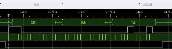

Slave chip requires SPI data lines toggle as shown in following picture:

}2017-07-08 3:41 AM
1. Couldn't able to toggle SS line as slave chip vendor suggested from High to low when clock and data present.
There's no hardware in STM32 which does this automatically. In newer models there's a 'toggle' mode which would frame each byte/word - this is not what you want and you don't have that in the ancient STM32F1xx you are using anyway.
So you have to do that 'manually', setting the NSS pin to GPIO output and setting it as needed before transmission and after the transmission has been completed (and setting NSS in SPI to soft and inactive).
2. There is a long gap in between each byte transmission
I don't know what incarnation of HAL_SPI_Transmit() you use, but I looked at the one in CubeF4 v1.16 and it has a timeout management, which in case of compiler optimizations off may take up quite a bit of processor cycles; now given your rather high SPI clock (hspi1.Init.BaudRatePrescaler = SPI_BAUDRATEPRESCALER_4;) this may in such setup seem to be 'long'.
