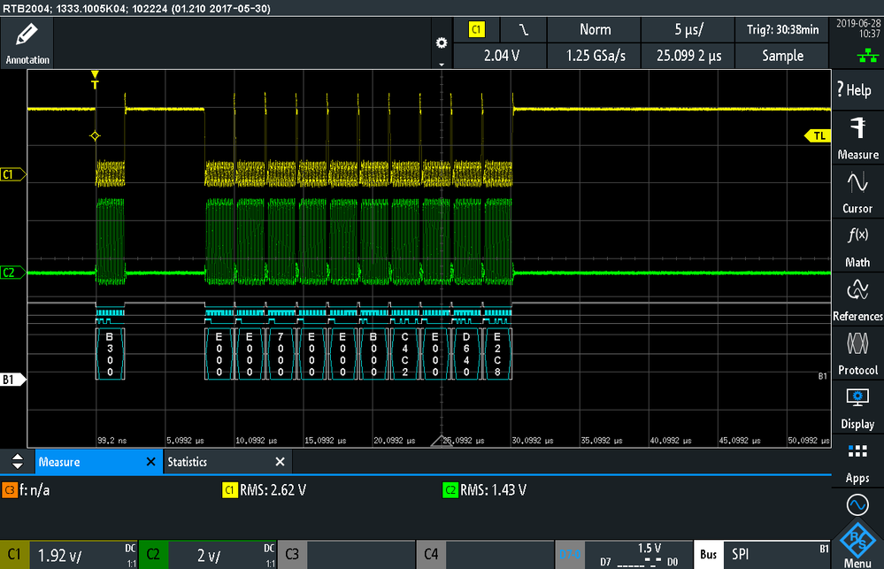

next picture shows the required behavior as it runs on STM32H743

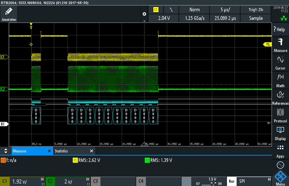

next picture shows what happen without pulsating NSS
there's no time between bytes to intorduce NSS pulse manually using timer or GPIO

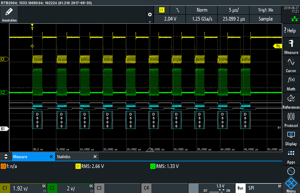

The only solution which I have now is using SW NSS and send SPI data byte by byte -No DMA and no Bursts- but the problems is that it's much s;lower and the overhead on controller as shown in next picture

The simplest solution is to feed the SPI Tx from DMA triggered by a channel of the same timer which generates the framing. Care must be taken if there's significant load on the given DMA and related buses.
A more secure but also more complex solution, at the cost of two timers and some pins is, to generate both SCK and framing by the timers, and feed them back to SPI, which is run as a slave.
A mix of these two approaches might be possible, or other solutions too. You have to have a good command of the timers and SPI; this is not something simply clickable in CubeMX.
You may want to have a look and at the TI mode - it's not the same as pulsing between frames, but maybe it fits your slaves' requirements (of which you've told us nothing yet).
