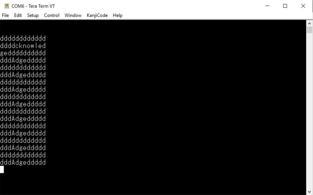

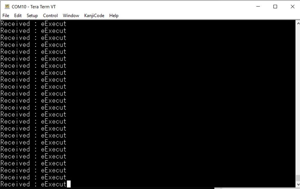

But with the code shown above, this is what I get
On master side:
On slave side:
The slave side seems to be receiving it somewhat correctly, while the master is receiving absolutely wrong message.

The master side
The slave side
Calling uart_txstr() in the slave loop guarantees that the slave is always late to the party, and can't respond in time.
