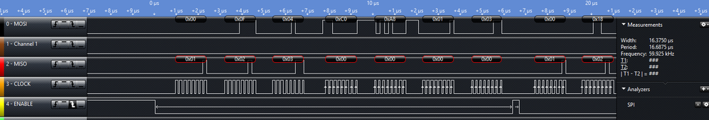

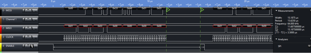

We are working on STM32F417.We are getting a ''problem'' (if it is a problem) with the SPI through DMA.The function which send data through SPI is selecting the device at the beggining and unselecting it after the transfer.With a normal SPI transmission we get the ''unselect device'' right after the transmission is completed, for any baud rate prescaler. (see printscreen with a baud rate prescaler of 8)2014-06-02 5:58 AM
