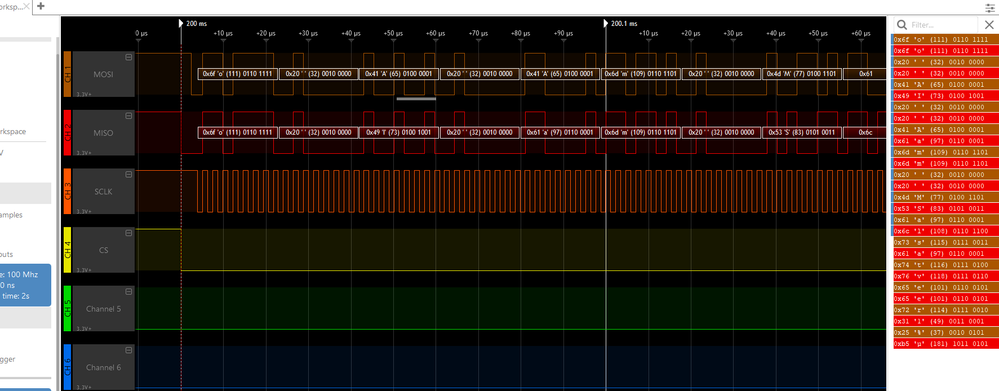

Please see picture below from logic analyzer reading
The message is definitely improved but some letters are off and the start of the message is cut of for some reason
The messages sent is: "hello I am Master" and "hello I am Slave1"
Yes, exactly. The trace looks perfect, except that it’s not sending what you want. Not sure. I dont see any issues in the code that you posted. I would guess the issue is elsewhere.
