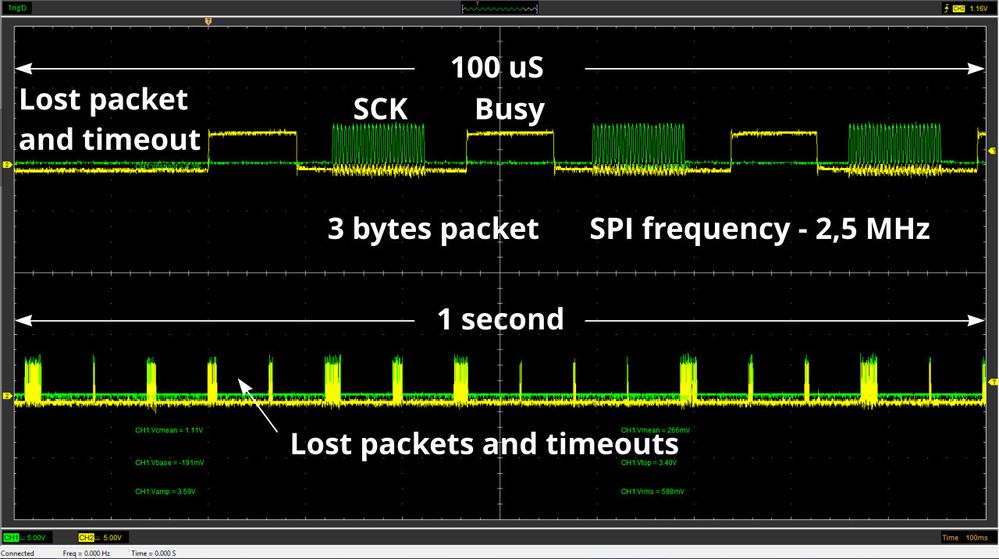

F722 SPI transactions (at any speed and any mode of operation - blocking, IT, DMA) in Slave mode occasionally led to error HAL_SPI_ERROR_FLAG after waiting for SPI_FLAG_BSY timeout. Data flow had lost packets and too many breaks as shown below:

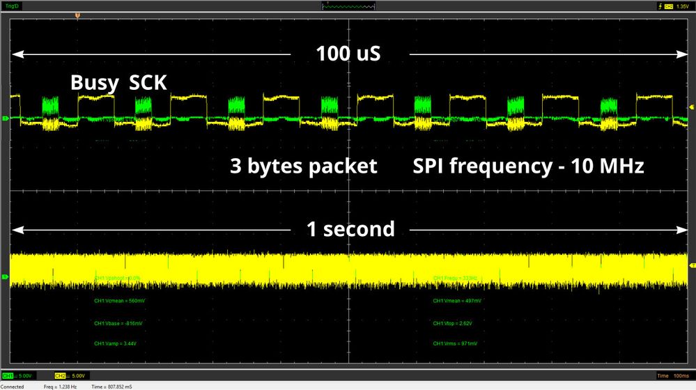

}Percent of errors amounted 0.21, 0.32 and 0.45% for different slaves independently of speed (tested on 156KHz, 2.5MHz, 10 and 20 MHz)
There was no other way but to change the source code of the HAL to launch the project. At first SPI_FLAG_BSY checking was ignored in the SPI_WaitFlagStateUntilTimeout function. This completely removed errors on the slave side:

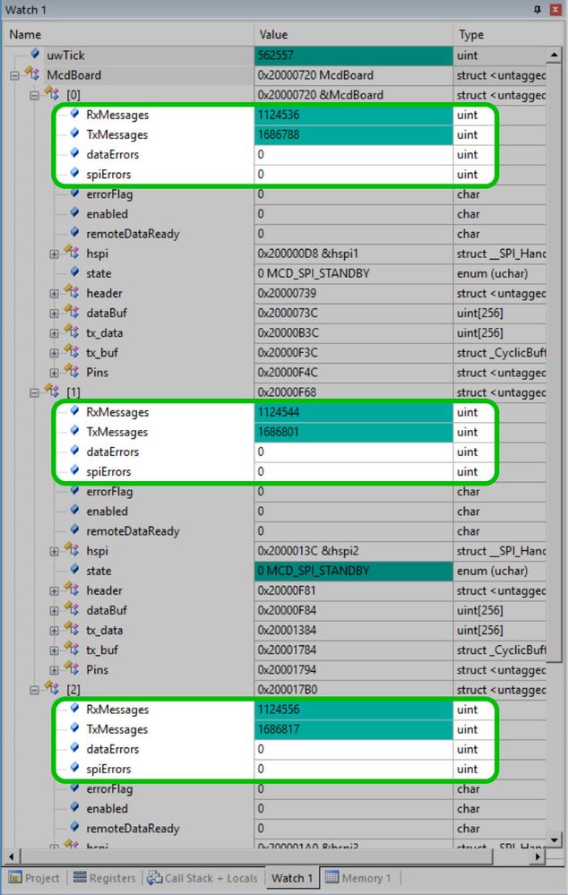

At last, Full Duplex data exchange between Master and three Slaves became healthy. For example there is a result of continuous ping-pong test with 64 bytes packets (full working program and protocol, DMA, 40 MHz SPI SCK frequency):
Even though it works, I think this is not nice solution. Therefore the question : is there any better way to resolve this problem without modifying the automatically generated by CubeMX sources?

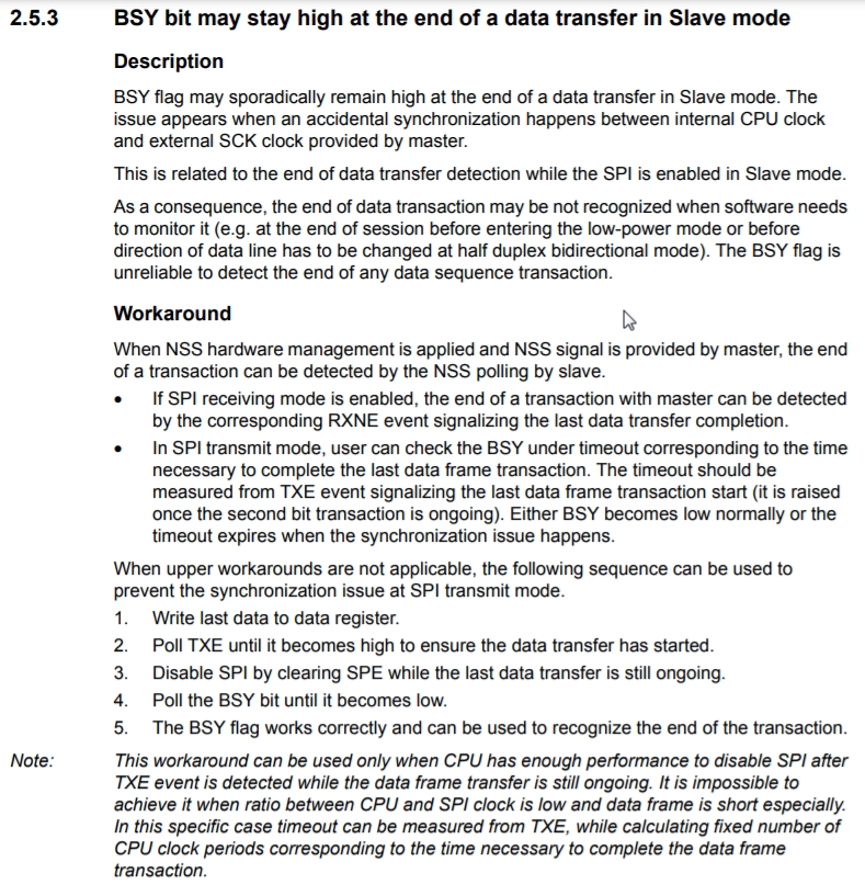

As I saw, SPI_BSY flag is a known issue for various ST MCUs. For example, that was described in STM32F446xC/xE Errata sheet, and workaround is polling TXE, but such way is not particularly applicable at high speed.

let me to comment your communication thread. Above all, the BSY bit monitoring at the end of the session is necessary at case the SPI slave at transmit only mode needs to be reconfigured or disabled after the latest session is fully completed (e.g. prior switching the slave into a low power mode). The main sense is to prevent any corruption of the ongoing session by such a premature action. Note the driver has to be written in conservative and universal way to cover all such cases. That is why the BSY test is included there to close the session safely. If the slave always stays active listening the bus there is no need to check BSY status once the expected number of data is applied by DMA and especially if the slave is receiver exclusively and the DMA reception session is completed.
