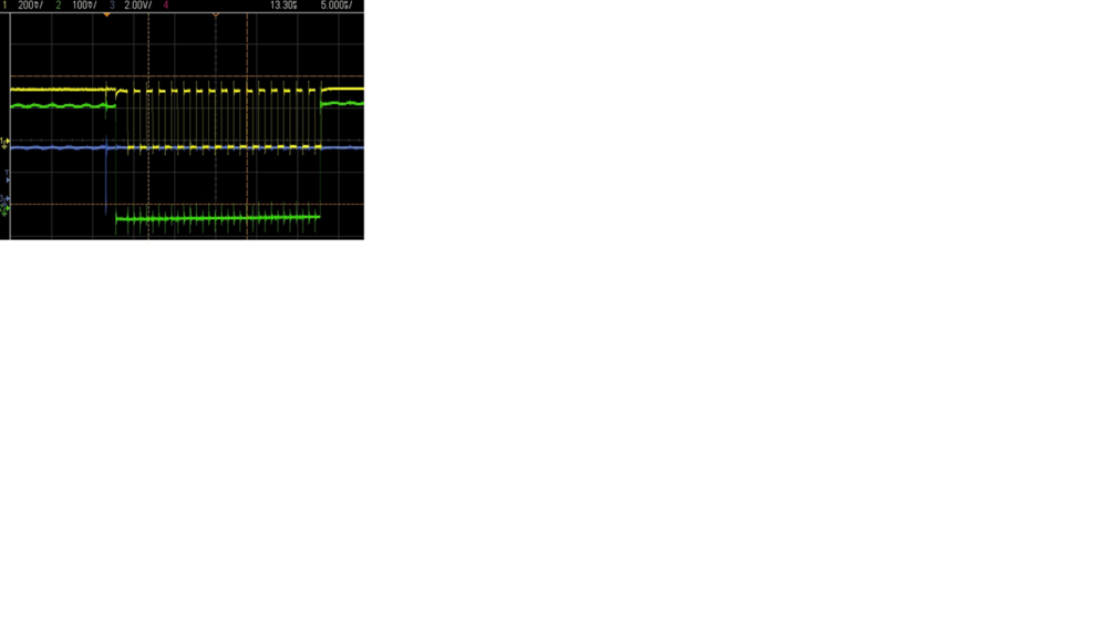

When ADCx_TRIG is an I/O that initiated sample from the A/D and the SPIx_APIT_CS config as a I/O.
This code is working good as you see in the first figure (yellow is clk, grin is CS and blue is trig for A/D)

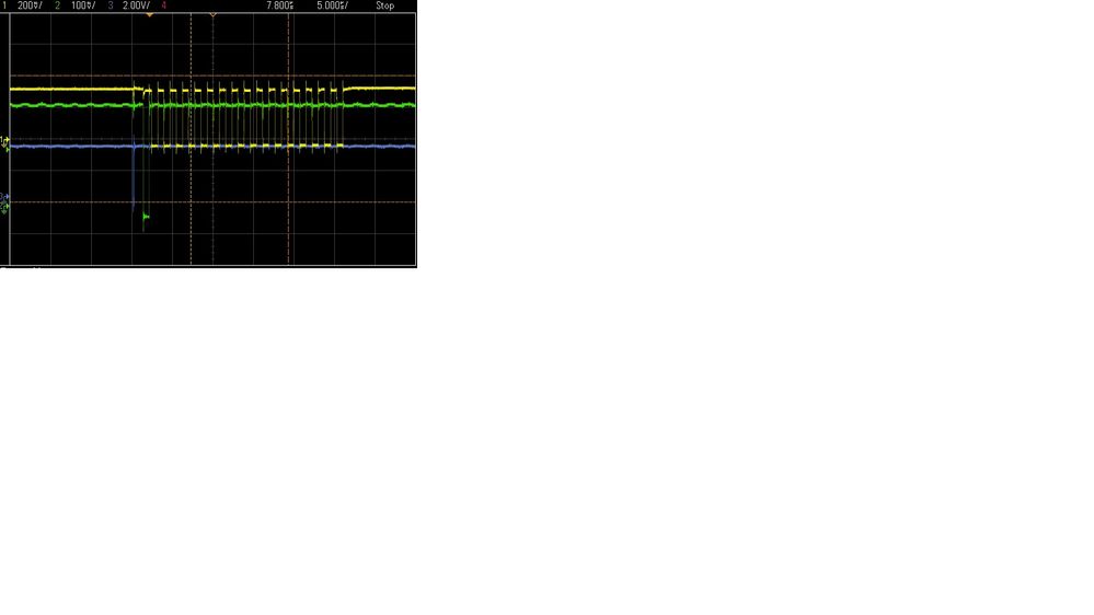

Bat sometime (one in 300) the CS is up before time see the second figure and then I get fault data in my reading.

but my problem is not overclocking, the problem is that the cs go highbefore the time, the processor does not stay inside the while and gmp to the next line.2014-09-14 10:57 AM
OK, I'll try to make it more simple.
If the processor do not stay into the while, it is because there is already a received char as soon as you enable SPI. How is this possible ? Certainly because the extra character has been arrived with the previous frame (try to catch the previous frame with your scope). Use an assert before enabling the SPI to check that the SPI has no character inside the RX buffer, when it has one, just read it to clear RXNE.2014-09-29 5:28 AM
