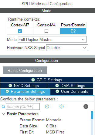

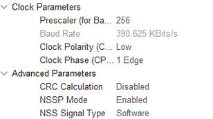

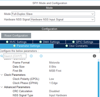

I am trying to figure out SPI communication between two microcontrollers: I have an STM32H755 Nucleo and a Nucleo G47RE. I tested basic communication by shorting MOSI and MISO on both boards separately, and it works in full duplex master mode. Both core are running at 100Mhz The G4 is the slave and it is receiving some data, but it is corrupted. What could be the potential reason?
These are my configurations and code:

// SPI1 Initialization
static void MX_SPI1_Init(void) {
hspi1.Instance = SPI1;
hspi1.Init.Mode = SPI_MODE_SLAVE;
hspi1.Init.Direction = SPI_DIRECTION_2LINES;
hspi1.Init.DataSize = SPI_DATASIZE_8BIT;
hspi1.Init.CLKPolarity = SPI_POLARITY_LOW;
hspi1.Init.CLKPhase = SPI_PHASE_1EDGE;
hspi1.Init.NSS = SPI_NSS_HARD_INPUT;
hspi1.Init.FirstBit = SPI_FIRSTBIT_MSB;
hspi1.Init.TIMode = SPI_TIMODE_DISABLE;
hspi1.Init.CRCCalculation = SPI_CRCCALCULATION_DISABLE;
hspi1.Init.CRCPolynomial = 7;
hspi1.Init.CRCLength = SPI_CRC_LENGTH_DATASIZE;
hspi1.Init.NSSPMode = SPI_NSS_PULSE_DISABLE;
if (HAL_SPI_Init(&hspi1) != HAL_OK) {
Error_Handler();

* Master Code
// Main Function
int main(void) {
HAL_Init();
SystemClock_Config();
// Initialize all configured peripherals
MX_GPIO_Init();
MX_SPI1_Init();
// Initialize LEDs
BSP_LED_Init(LED_GREEN);
BSP_LED_Init(LED_YELLOW);
BSP_LED_Init(LED_RED);
// Initialize USER push-button
BSP_PB_Init(BUTTON_USER, BUTTON_MODE_EXTI);
// Initialize COM1 port
COM_InitTypeDef BspCOMInit;
BspCOMInit.BaudRate = 115200;
BspCOMInit.WordLength = COM_WORDLENGTH_8B;
BspCOMInit.StopBits = COM_STOPBITS_1;
BspCOMInit.Parity = COM_PARITY_NONE;
BspCOMInit.HwFlowCtl = COM_HWCONTROL_NONE;
if (BSP_COM_Init(COM1, &BspCOMInit) != BSP_ERROR_NONE) {
Error_Handler();
// Print welcome message
printf("Welcome to STM32 world!\n\r");
// Infinite loop
while (1) {
if (switch_state) {
BSP_LED_On(LED2);
status = HAL_SPI_Transmit_IT(&hspi1, tx_buffer, sizeof(tx_buffer));
printf("status=%d\n", status);
HAL_Delay(500);
BSP_LED_Off(LED2);
HAL_Delay(500);
if (rx_flg) {
rx_flg = false;
printf("%s", rx_buffer);
hspi1.Init.Mode = SPI_MODE_MASTER;
hspi1.Init.NSS = SPI_NSS_SOFT;
hspi1.Init.BaudRatePrescaler = SPI_BAUDRATEPRESCALER_256;
hspi1.Init.CRCPolynomial = 0x0;
hspi1.Init.NSSPMode = SPI_NSS_PULSE_ENABLE;
hspi1.Init.NSSPolarity = SPI_NSS_POLARITY_LOW;
hspi1.Init.FifoThreshold = SPI_FIFO_THRESHOLD_01DATA;
hspi1.Init.TxCRCInitializationPattern = SPI_CRC_INITIALIZATION_ALL_ZERO_PATTERN;
hspi1.Init.RxCRCInitializationPattern = SPI_CRC_INITIALIZATION_ALL_ZERO_PATTERN;
hspi1.Init.MasterSSIdleness = SPI_MASTER_SS_IDLENESS_00CYCLE;
hspi1.Init.MasterInterDataIdleness = SPI_MASTER_INTERDATA_IDLENESS_00CYCLE;
hspi1.Init.MasterReceiverAutoSusp = SPI_MASTER_RX_AUTOSUSP_DISABLE;
hspi1.Init.MasterKeepIOState = SPI_MASTER_KEEP_IO_STATE_DISABLE;
hspi1.Init.IOSwap = SPI_IO_SWAP_DISABLE;
Error_Handler();

Hello @KDJEM.1 ,
Thank you for the input. I am pretty much new to the STM environment, and I am slowly getting the hang of it. Based on your input, I referred to the example and just disabled the slave-side hardware NSS. Viola! It started working.
