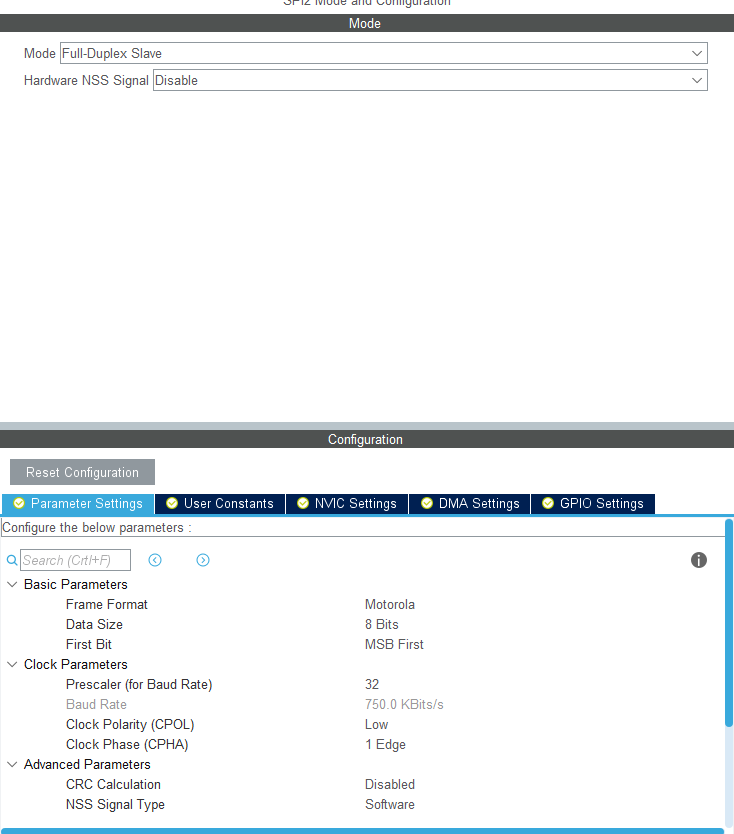

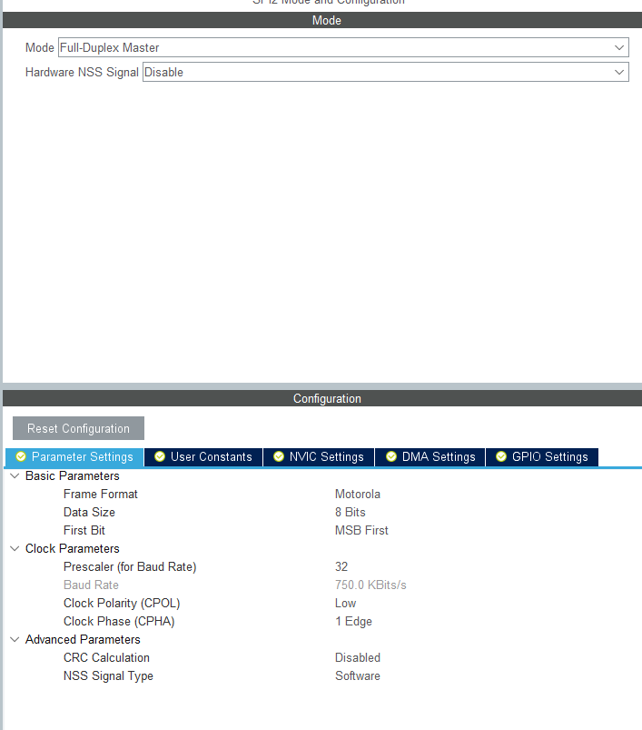

Here is the config for the SPI in master mode.
And this is config of SPI in slave mode.
I am using HAL codes to implement. Latest is the following codes that i tried last. I have set the SS pin to ground manually.
Master side:
counter = (counter > 4) ? 0 : counter;
HAL_SPI_Transmit(&hspi2, (uint8_t *)&UID[counter], 1, HAL_MAX_DELAY);
HAL_Delay(1000);
HAL_SPI_Receive(&hspi2, (uint8_t *)&txBuf[counter], 1, HAL_MAX_DELAY);
HAL_Delay(1000);
counter++;Slave Side:
HAL_SPI_Receive( &hspi2, (uint8_t *)&rxBuffer[counter], 1, HAL_MAX_DELAY);
HAL_Delay(1000);
HAL_SPI_Transmit( &hspi2, (uint8_t *)&uid[counter], 1, HAL_MAX_DELAY);
HAL_Delay(1000);
counter++;Its pretty simple, where master is sending 5 bytes (one by one)
and Slave is sending 5 bytes (one by one) but its transmitting after it has received successfully.
