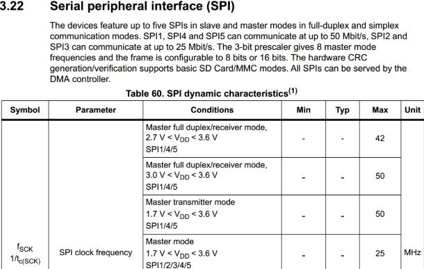

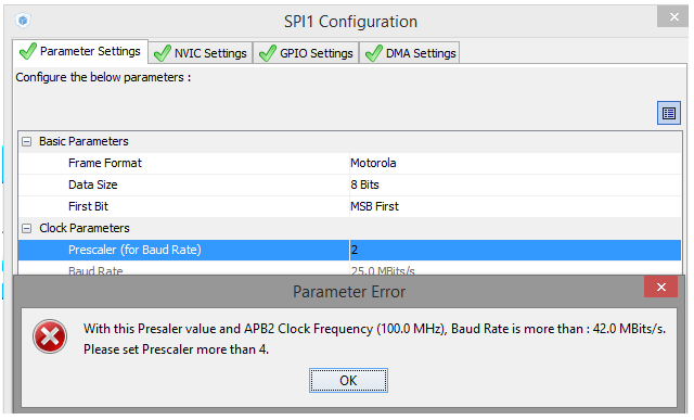

For the STM32F411, I set SPI 1 as a Full Duplex Master.
In the RCC Configuration, I set the VDD voltage to 3.3V. In the SPI1 Configuration, I try to set the SPI Prescaler to /2 for a Baud Rate of 50.0 MBits/s, I get an error. According to the documentation, it should be fine.2014-09-26 1:44 AM
Hi HarjitS,
I've succedded to reproduce the issue, thank you for bringing it to our attention. We’ll pass it along to our STM32CubeMX team. Keep an eye out for the next update!Regards,Heisenberg.We’re moving the ST Community to a new platform to give you a better and more reliable community experience.
