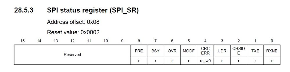

>>>Um, SPI_SR_BSY is 0x80, not 0x01.

You're doing a bit wise AND so 0x40 & 0x80 = 0, so a comparison with 0 or not 0 will work
0x80 & 0x80 = 0x80
It is a bit in a register, ie bit 7, or (1 << 7)

At the above code (SPI3->SR & SPI_SR_BSY) is not a logical argument but an arithmetic value.
This means, if this value is not equal to another arithmetic value like 1 the logic ((SPI3->SR & SPI_SR_BSY) == 1) will never be true because 0x0080 or 0x0000 (SR register ANDed with 0x0080) is never equal to one!
