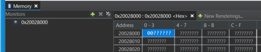

Thanks to all of you who responded. From your advice I was able to track the culprit down to the transmit routine.
Conclusion:
While trying to load the transmitter register with data, location 0x20028000 is read which is outside of accessible memory which causes the fault.

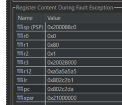

Fault Analyzer:
1) Buss, memory management or usage fault (FORCED).
2) Precise data access violation (PRECISERR).
3) Register content during fault exception:
a. Stack Pointer (PSP) at 0x200088C0.
b. Link Register at 0x802C2B1.
c. Program Counter at 0x802C2DA.
The fault happened while executing huart->Instance->TDR = (uint8_t)(*pdata8bits & 0xFFU);
1104 huart->Instance->TDR = (uint8_t)(*pdata8bits & 0xFFU);
0x0802c2d8: 0x0000fb69 ldr r3, [r7, #28]
0x0802c2da: 0x00001a78 ldrb r2, [r3, #0] r3 contains 0x20028000
0x20028000 is at the end of accessible memory. Reading a word from this location causes a bus fault.
