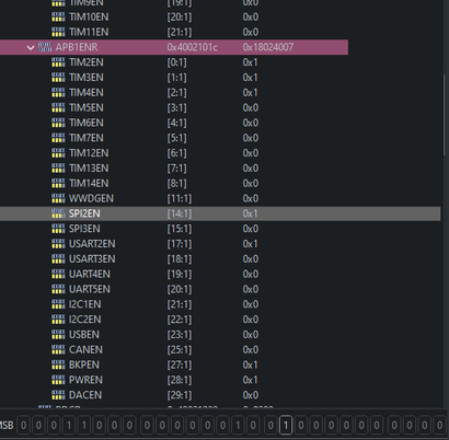

I can toggle SPI2EN bit inside APB1ENR register in Debug mode and see the same outcome:

This is consequence of the rather peculiar GPIO arrangement of the 'F1 (every other STM32 uses a different, more complete GPIO matrix). Basically, as soon as you enable SPI2, it occupies pins PB13, PB14 and PB15 and there's no workaround to it. Some peripherals can be remapped to other pins, but not SPI2.
