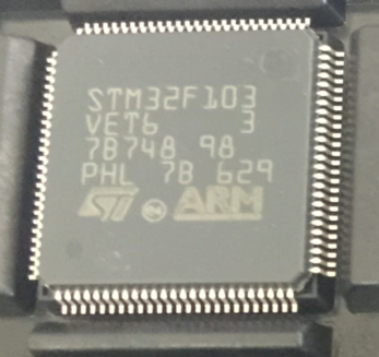

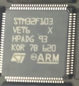

I guess any quality analysis would require at least a picture of the package marking and a picture of the sticker reel (which would give origin info) for anyone to dig further.

Here are the label and marking photos.
