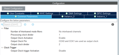

If you have configure your project from CubeMX, in common parameters of MDF1, select "CCK0 and CCK1 are used as output clock" for Output clock Pin setting
Then, in MX_MDF1_Init, make sure you get the following configuration:
MdfHandle0.Init.CommonParam.OutputClock.Pins = MDF_OUTPUT_CLOCK_ALL;
