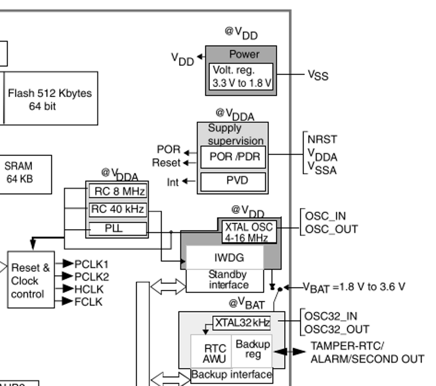

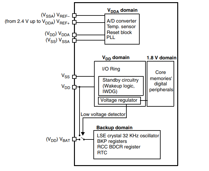

In Section 3.5.1 of the STM32F031 datasheet states:
The V
DDA
voltage level must be always greater or equal to the V
DD
voltage level and must be established first.
�The statement �
V
DD
� is a bit confusing. Does this imply some sort sequencing is required? Or can the two pins be tie together?#stm32f031-power-scheme-sequencing2018-03-04 9:15 PM
I think
Because VDDA power up the clock, it need to be first to make sure MCU running correctly and not making any annoying things to the IO.
it seems it can be tied together.
because the demo board did tie.
for that reason, the quote from ST confuse me too!
