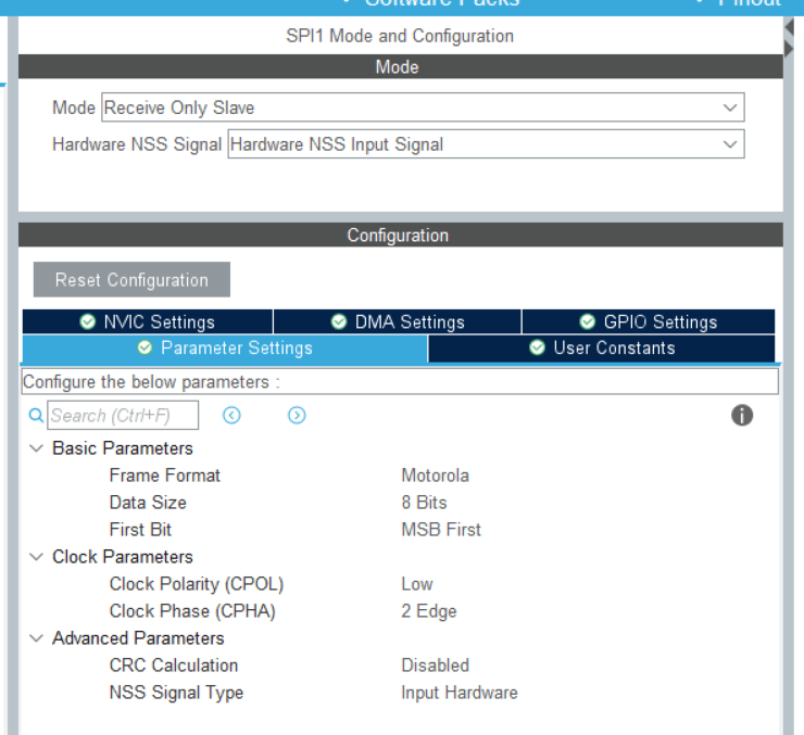

I have configured an SPI as receive-only slave in CubeMX and have set NSS to "Hardware input signal":
From logical point of view I now would expect, that there are no SPI data received, as long as NSS stays at high.
However, the CubeMX-generated code still jumps into the SPI-ISR SPI1_IRQHandler() also when NSS is not at LOW.
So my question: what am I doing wrong? How do I have to configure the SPI to respect the NSS/SYNC signal on receiving?
Thanks!

In case of SPI1, the NSS-pin is PA4. But this is not a GPIO-pin, CubeMX deals with it as SPI-NSS-pin where no possibilities exist to have the generic GPIO settings. And within the SPI-settings I can not change any parameters for this pin except than turning NSS on or off ("NSS signal type" is "Input Hardware" as shown in image above).

Once again: the NSS-input is NOT an GPIO-pin but a SPI-signal which should be handled by the SPI-hardware! So reading the GPIO-registers for PA4 does not make any sense as the GPI is set to "alternate function" and therefore this register does not reflect the state of the NSS-pin!
The problem is the SPI-hardware not handling the NSS-signal according to what it should do, this SPI-related and has nothing to do with some GPIOs.
In SR-register the flags BSY, OVR (may be because the software is halted in debugger while data transmission is still running), TXE and RXE are set.
