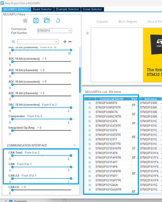

You can use STM32CUbeMx or STM32Finder tools to select the suitable MCU for your application:

So if you mean by simple not a very complex MCU I can suggest STM32F0 family based on Cortex-M0:
