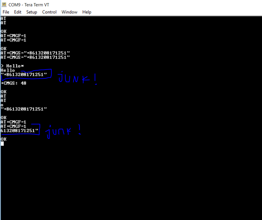

I'm trying to send message to sim900A via the serial port. The AT commands work but the GSM replies with some unwanted text (Previously sent text ) then finally OK. The GSM is supposed to reply what I typed with some prompts and finally OK. The picture below clearly tells what's happening. Is there any way to delete the data on the GSM buffer (If there is any) before sending a new one?
