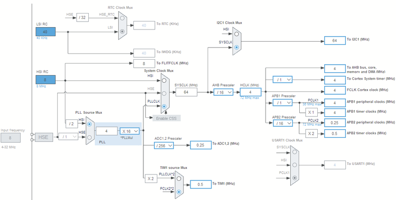

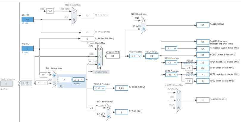

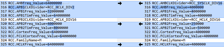

I'm in the middle of attempting to reconfigure the clock tree on my STM32F303K8. The old clock tree looks like
The new clock tree looks like

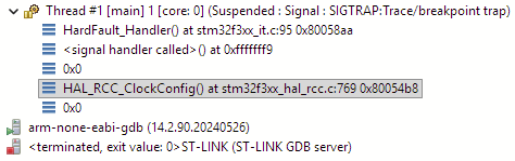

The old clock tree works fine. The new clock tree always fails on boot; not always in the same address but always in the neighbourhood of HAL_RCC_ClockConfig. An example stack trace looks like
In this case it claims to have failed on this line 769 of HAL_RCC_ClockConfig:
/* Get Start Tick */
tickstart = HAL_GetTick();This is failing in the MX-generated code well before any of my own code runs. The goal is to keep the CPU clock at 64 MHz but reduce everything after the AHB prescaler. The diff of the RCC section in the .ioc file looks like this:

The reference manual would be the correct place to look for that info.
HCLK of 4 MHz doesn't require wait states.
Not entirely sure where the cortex clock is here.
RM says that HCLK is the Cortex clock which aligns with the RMs specifications on wait states.
Changing wait states to 2 suggests this may be incorrect, but the RM is typically the best source of info.

If I step through, it's this line that seems to smash the stack:
if ((HAL_GetTick() - tickstart) > CLOCKSWITCH_TIMEOUT_VALUE)

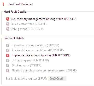

Not real sure, but what I would do is look at the RCC clock settings at the register level after or as they are set by HAL_RCC_ClockConfig and validate those against what is allowed per the reference manual. Perhaps look just prior to the system clock being changed at __HAL_RCC_SYSCLK_CONFIG.
Consider looking into the reason for the hard fault. STM32CubeIDE has a hard fault analyzer. Window -> Show View -> Fault Analyzer. Probably going to see an IMPRECISE_ERR which is hard to pin down but is usually something fundamentally wrong with the clock settings. Occasionally due to a power issue but if you're reducing the clock I doubt that's the case here.
2025-11-20 9:24 AM

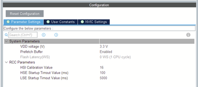

The only other suspicious thing I saw was that MX modified this parameter:
FLASH_LATENCY_2
to
FLASH_LATENCY_0
2025-11-20 9:36 AM - edited 2025-11-20 9:48 AM
Right, so manually reverting FLASH_LATENCY_0 to FLASH_LATENCY_2 fixes the issue. Searching the internet for this symbol didn't turn up much. I wonder what's going on here. FLASH_LATENCY_1 also succeeds.
MX even has a field for this, but it's disabled:

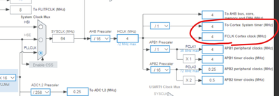

2025-11-20 9:48 AM - edited 2025-11-20 9:52 AM
2025-11-20 10:23 AM
@TDK wrote:> The goal is to keep the CPU clock at 64 MHz but reduce everything after the AHB prescaler.
Sigh. Yep. Back to 64 MHz, then...
