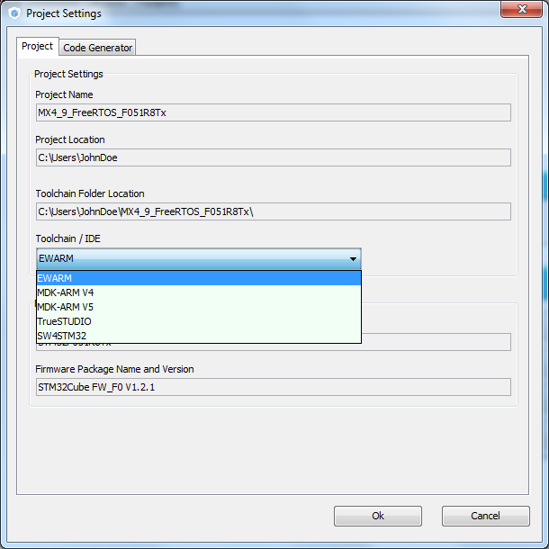

Hi Gerhard,
Altium Tasking is not a toolchain among the ''default'' ones supported in CubeMx GUI (cf screenshot).
