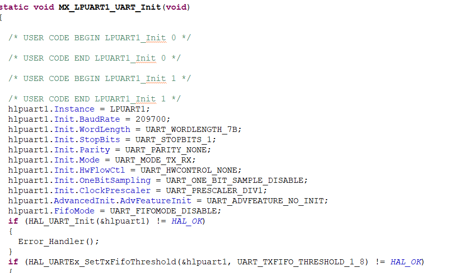

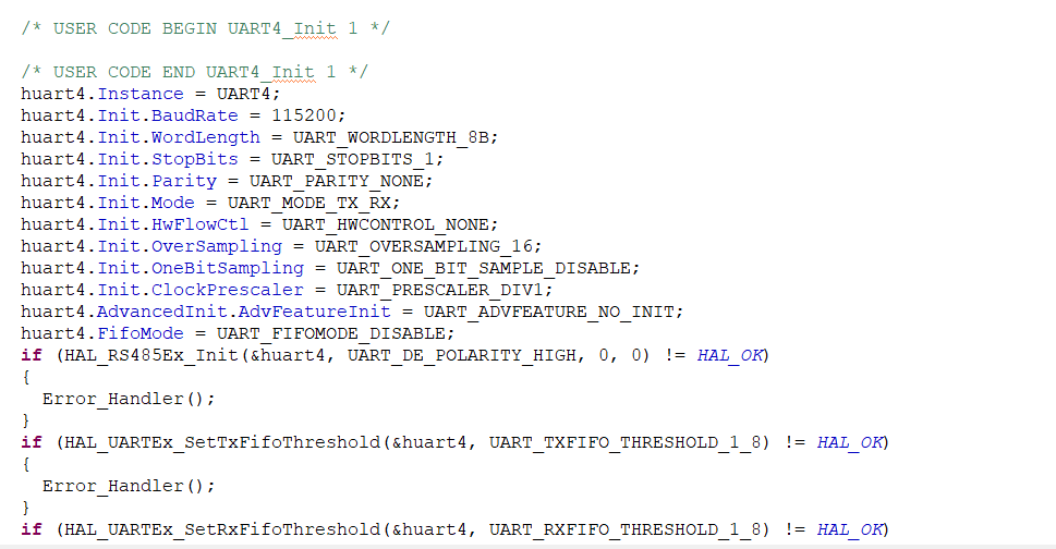

i am using stm32l4r5zi microcontroller .i have enabled all uart port 1,2,3,4,5 but this is not showing data on usb serial port .does l4r5 usb serial port not supporting ?
2023-04-14 11:20 PM
i have also change the baud rate in LPUART1 ,(209700 to 115200 ) but data not showing

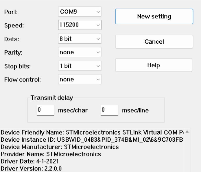

What board? How is your UART conected to your PC? Check the schematics; you will see which pins are connected to the UART interface. Setup the UART in CubeMX, double check that the proper pins are selected for it.

Why using 7-bit mode?

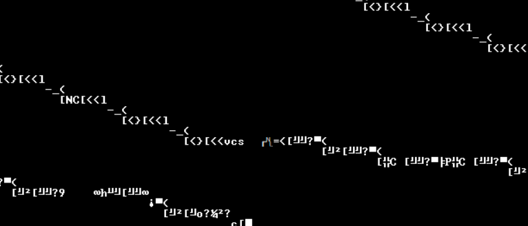

Mismatch in bit and baud modes of terminal vs UART.

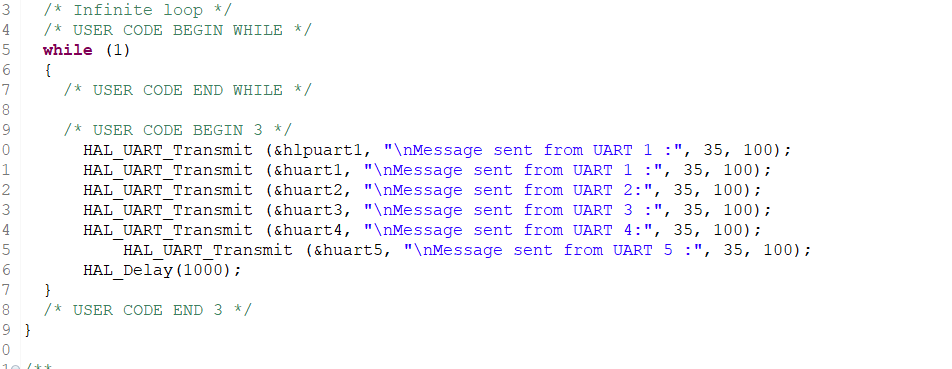

Write a string output function that computes length.

Don't use internal HSI/MSI RC clocks with that high baud-rate UART or try to slow down (to 9600 or lower). If you are using NUCLEO-L4R5ZI, the HSE oscillator is not populated. You have to use the MCO output from the ST-Link by closing SB109 and SB148 and setting HSE in bypass. That is what I experienced not a long time ago on the other L4 NUCLEO board. -wq
2023-04-15 1:29 PM
Not a problem. MSI may be synchronized to LSE, which is populated on Nucleo boards.
