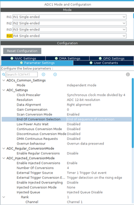

2024-01-16 11:52 AM - edited 2024-01-16 12:43 PM
setup adc1 :
then try to start it:
MX_ADC1_Init();
MX_TIM1_Init();
/* USER CODE BEGIN 2 */
HAL_ADCEx_Calibration_Start(&hadc1); // adc1 kalib.
HAL_Delay(2); // wait a little
HAL_ADCEx_InjectedStart_IT(&hadc1); // start adc for int mode
HAL_TIM_Base_Start(&htim1); // Trigger ADCs
/* USER CODE END 2 */
-> then set breakpoint in adc int , check results in debug mode...
