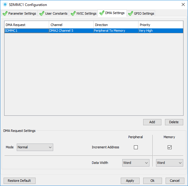

I have an issue with uSD reading and writing in DMA mode (How ever I am able to read and write data on SD card when dma template is off). I used CubeMX to configure
but it did not work for me ''out of the box''.

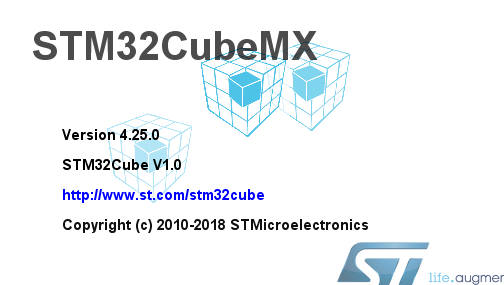

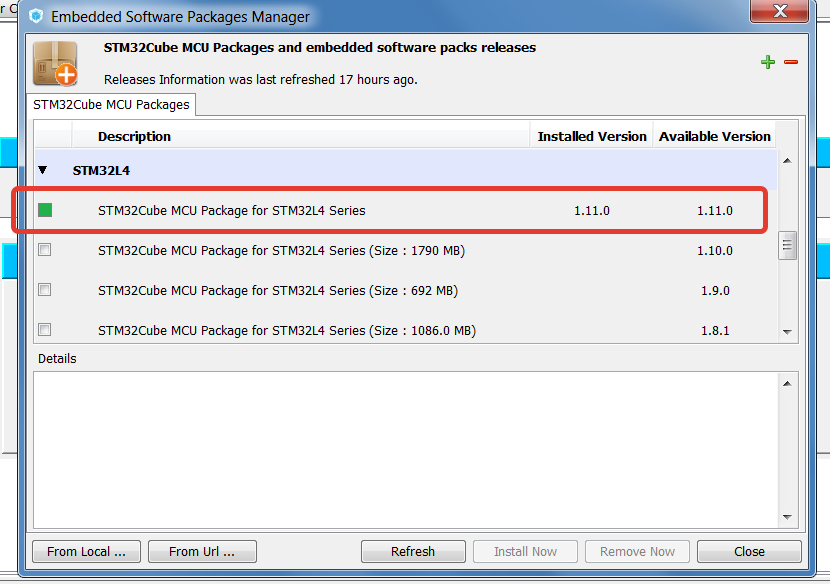

My CubeMX version is 4.25.0 and L4 MCU package is 1.11.0.
Could you point out what I am doing wrong in configuration or in my code or if it is CubeMX issue, could you please advice me how to solve it?

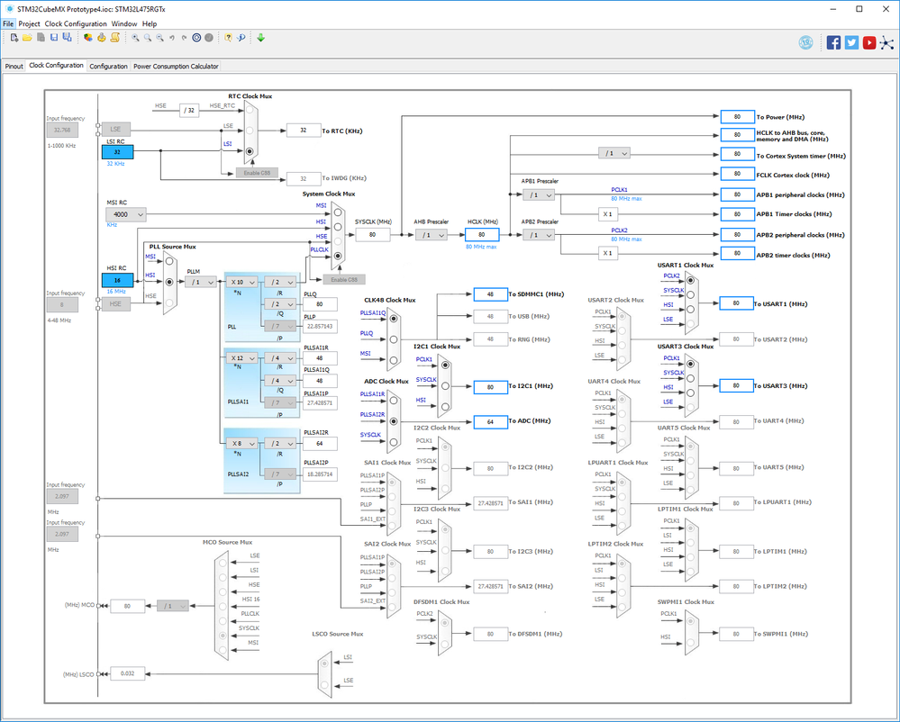

My MCU setup:
My CubeMX configuration:

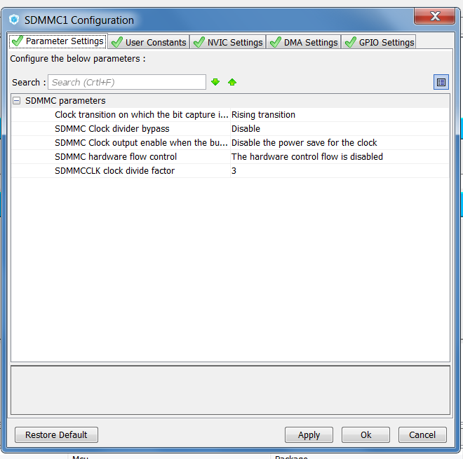

1) Clock
2)Clock factor

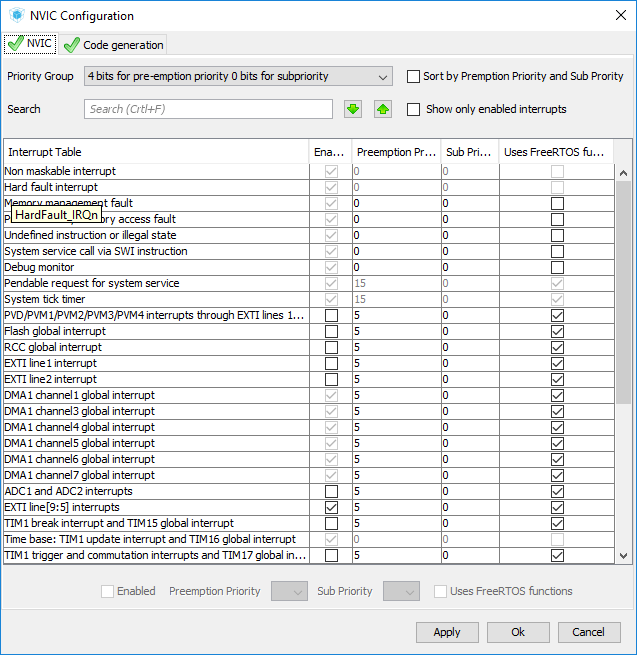

3)NVIC
4)DMA
5)Pin configuration
6)FatFS (sector size)
7)DMA template enabled

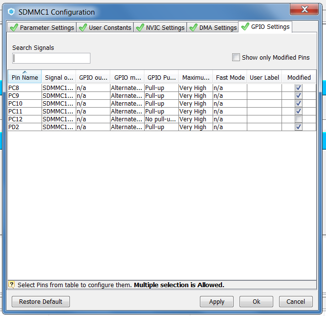

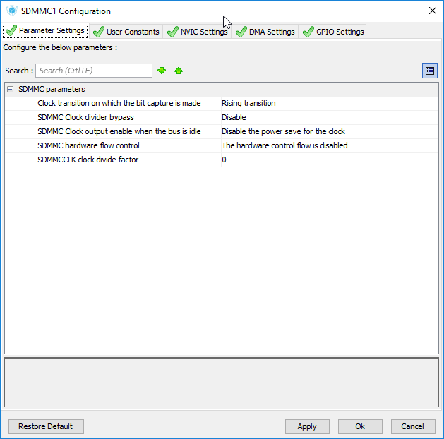

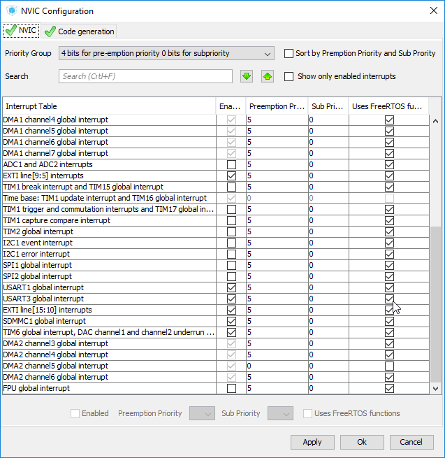

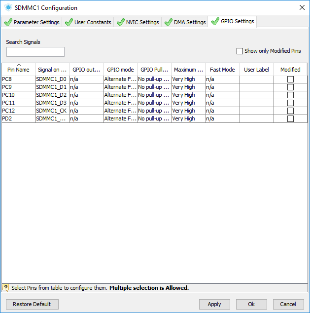

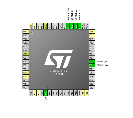

I also attached some screenshots, where I found differences between yours and my project configuration in CubeMX.

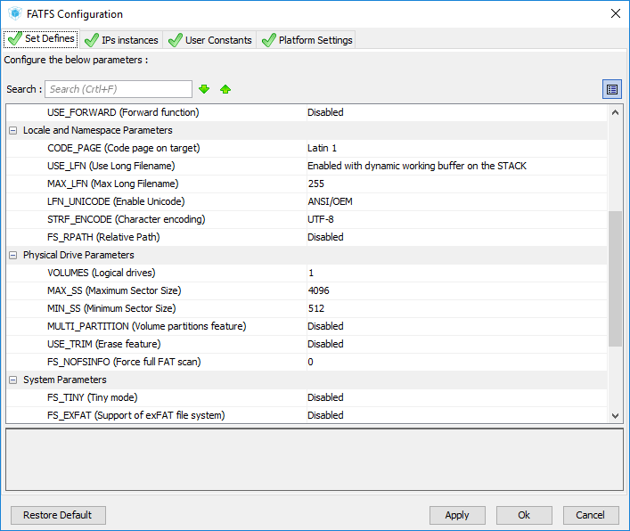

As you can see, I have SDMMC1 48MHz clock and SDMMCCCLK clock divider is set to 0. The DMA priority is Very High, but I don't think this should be an issue. Also, I don't use internal pull-ups since I have them externally. Finally, I enabled long filenames support in FatFs.
I hope this helps.

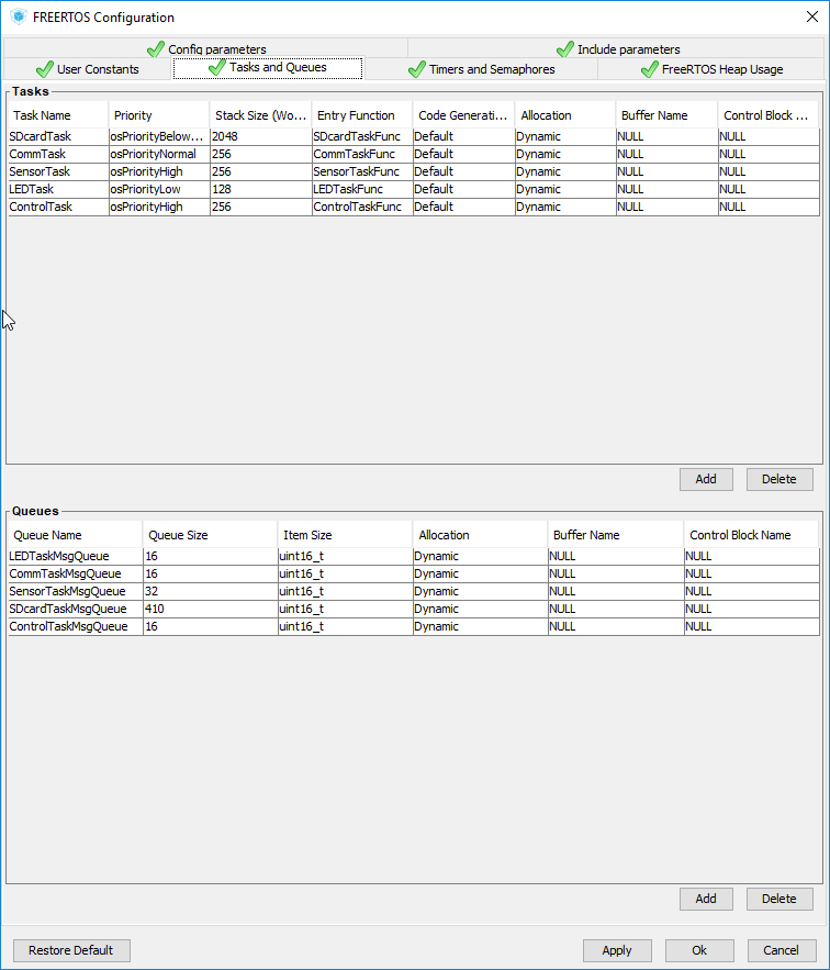

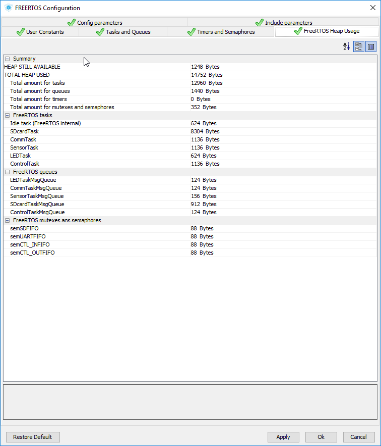

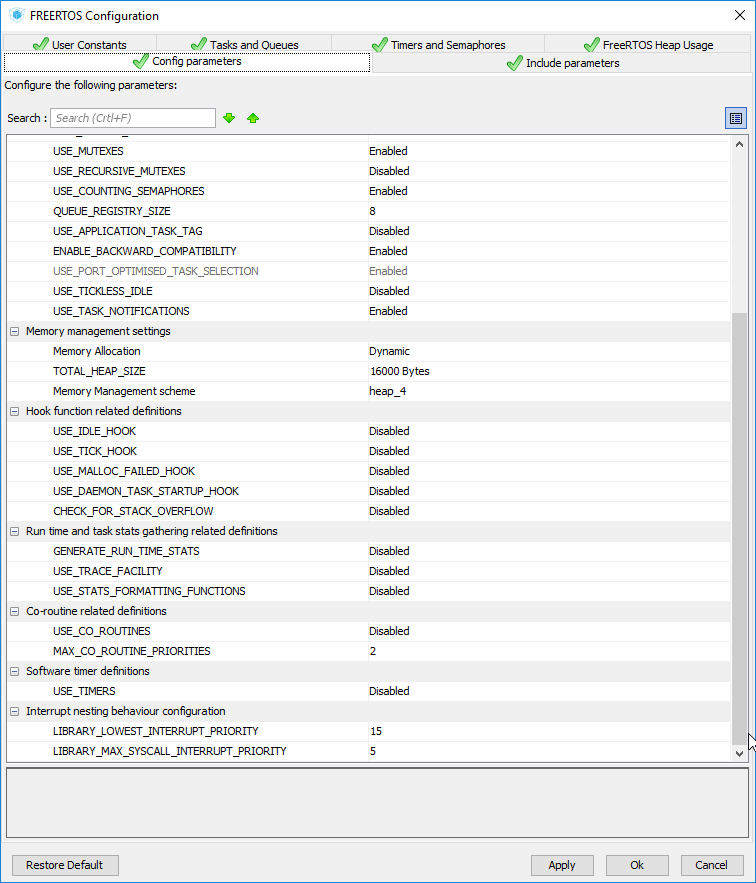

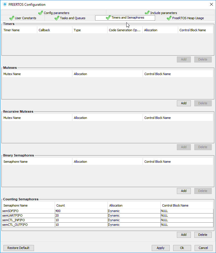

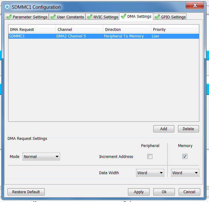

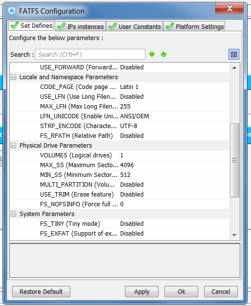

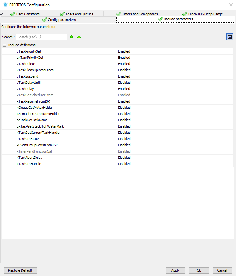

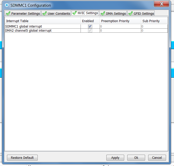

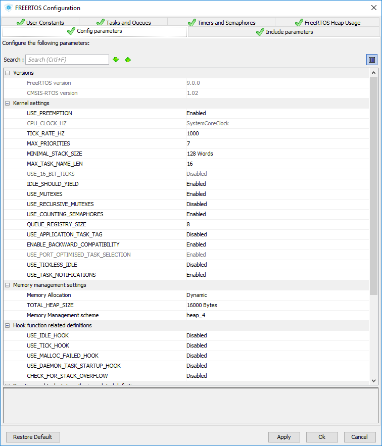

Posted on May 02, 2018 at 16:12
Hi Dmitry,
If you set a breakpoint in your task, does it stop there? If not, it might be an issue with task priorities (although, you have only one task?) Also, have a look at heap size.
Here are the screenshots of the settings from my project.
0690X0000060AtVQAU.png0690X0000060AxCQAU.png0690X0000060AxHQAU.png0690X0000060AxMQAU.png0690X0000060AxRQAU.png0690X0000060AxvQAE.png0690X0000060AxWQAU.png0690X0000060AxgQAE.png

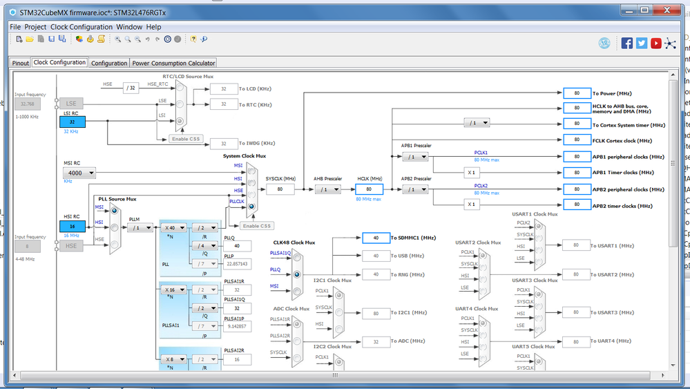

Posted on May 03, 2018 at 17:24
Dear Evgeny,
Thanks a lot for your support. I did a corrections according to your screen shots.
I found out that freezed program start was caused by error in timer configuration. I changed the input for sd card clock to PLLQ with 40MHz and it partially works now (I am able to blink a led in freertos:)).

4) I suggest to use short filenames written in lower case letters.
