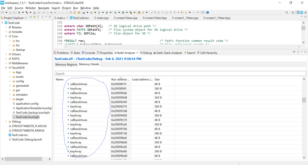

2021-02-06 8:32 AM
Please check the attached screenshot of memory details of my project.
Variables keyArray and callbackAreas, which are related to the keyboard are appeared so many times.
This is consuming lot of .bss segment in the RAM.
Even if I add keyboard on each screen, these variables should not get added separately for each screen.
