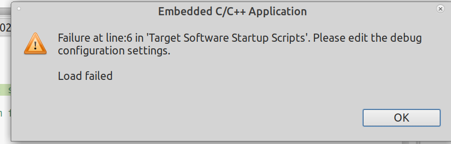

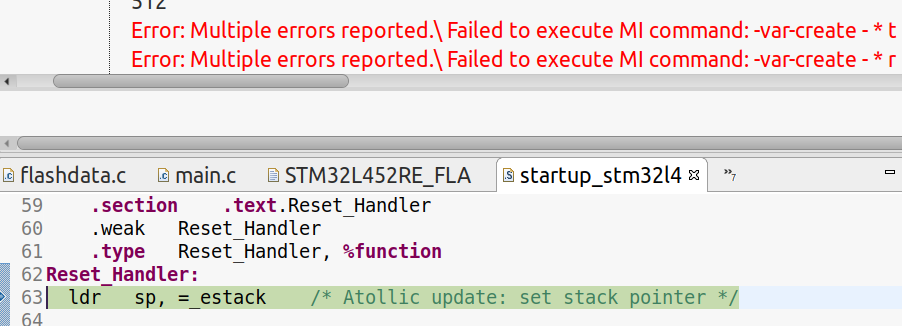

The program wont start.
I hangs in the startup file here:
The start hang here. Anything else I am missing.
