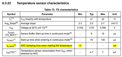

Also, how do I determine Sampling Time for the internal Channel Temperature Sensor (IN17)?
Sampling time requirements for the temp sensor are in the datasheet, but a little hard to find if you don't know it's there.

Thanks for pointing out where to find the Ts_temp. I adjusted my Tsmpl time for that channel and am getting much better temperature readings now. I did observer that when my Tsmpl for the temperature sensor was too low, the counts coming from the AtoD were ~40 counts too high, even with oversampling set to 256x.
