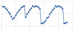

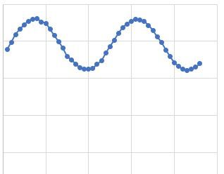

I am having a problem. I am using STM32F411CE and NRF24L01 module. I try to sample sound using ADC and then I send it using RF to another uC. I sample a simple sine wave at 48kHz with 16 bit resolution using IT. I send 32 bytes at one time using RF module so i can send 16 samples at one time cause 1 sample is 16 bit (2 bytes). When i get enough samples the flag is up and in the main there is a function that send the data. When I gather test data in the ADC interrupt i can see a nice sine wave so i know that the ADC is working properly.
But when I take te test data in main where I send the data i can see that the sine wave is chopped.I am using HAL libraries and the RF module library i found online.

2020-10-23 6:13 AM
How quickly are sending data?
Your chunks of sine wave readings are not multiples of 16. Seems like they should be if you're sending 16 readings at a time.

2020-10-23 6:51 AM
I tried at first sending samples with 8 bit resolution and the result was quite similar. In documentation it says that this module has 2Mbs air data rate and I am using that speed. I know it is theoretical but for now I try to sample one channel and obtain on the reciver side quite the same sine wave. I will try to use DMA for sampling. But still I do not now why the signal is in 8 sample chunks.
