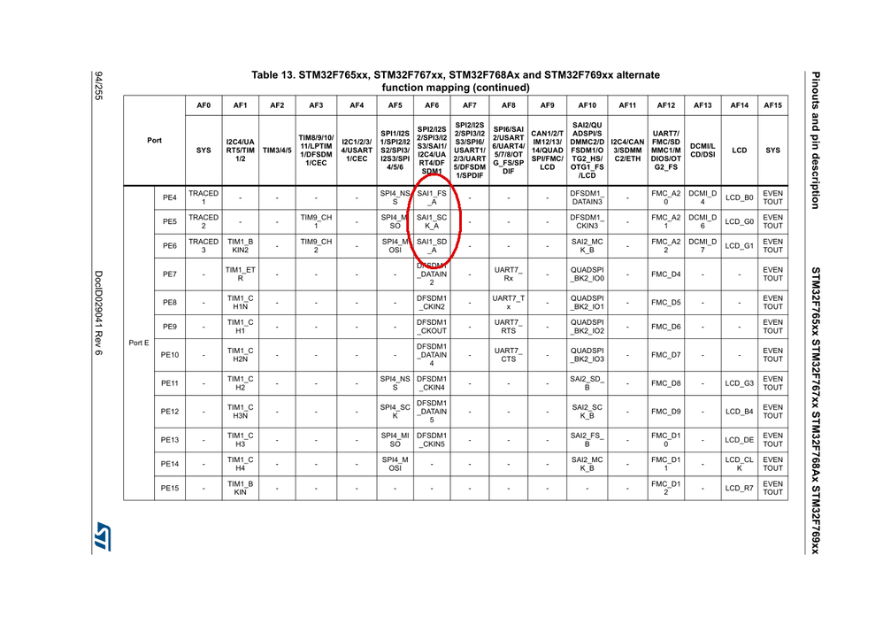

#define AUDIO_SAIx_FS_GPIO_PORT GPIOF // GPIOE
#define AUDIO_SAIx_FS_AF GPIO_AF6_SAI1#define AUDIO_SAIx_FS_PIN GPIO_PIN_6 // GPIO_PIN_4 //#define AUDIO_SAIx_SCK_GPIO_PORT GPIOF // GPIOE //
#define AUDIO_SAIx_SCK_AF GPIO_AF6_SAI1#define AUDIO_SAIx_SCK_PIN GPIO_PIN_7 // GPIO_PIN_5 //#define AUDIO_SAIx_SD_GPIO_PORT GPIOF // GPIOE //
#define AUDIO_SAIx_SD_AF GPIO_AF6_SAI1#define AUDIO_SAIx_SD_PIN GPIO_PIN_10 // GPIO_PIN_6 //#define AUDIO_SAIx_MCLK_GPIO_PORT GPIOA // GPIOG //
#define AUDIO_SAIx_MCLK_AF GPIO_AF6_SAI1#define AUDIO_SAIx_MCLK_PIN GPIO_PIN_6 // GPIO_PIN_7 // #define AUDIO_SAIx_MCLK_ENABLE() __HAL_RCC_GPIOA_CLK_ENABLE() // __HAL_RCC_GPIOG_CLK_ENABLE() // #define AUDIO_SAIx_SCK_ENABLE() __HAL_RCC_GPIOF_CLK_ENABLE() // __HAL_RCC_GPIOE_CLK_ENABLE() //#define AUDIO_SAIx_FS_ENABLE() __HAL_RCC_GPIOF_CLK_ENABLE() // __HAL_RCC_GPIOE_CLK_ENABLE() // #define AUDIO_SAIx_SD_ENABLE() __HAL_RCC_GPIOF_CLK_ENABLE() // __HAL_RCC_GPIOE_CLK_ENABLE() //2018-06-16 7:59 AM

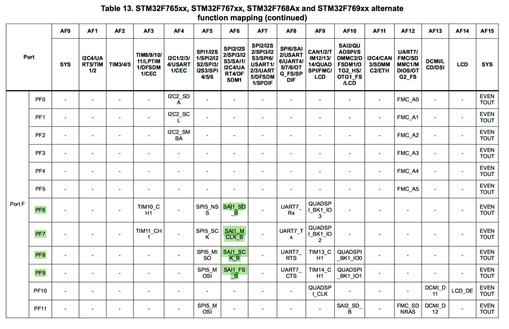

You cannot assign function block signals to arbitrary pins of the mcu, see the Alternate function mapping table in datasheet, for example:

I tried these pins , I have
5.6mhz mclk
705khz sclk
but the SAI example code is stuck here without any callbacks being triggered
/* Wait a callback event */
while(UpdatePointer==-1),does the SAI example need to be hooked to anything in order for ,HAL_SAI_TxHalfCpltCallback to trigger ?
I just have the SAI1_B pins hooked up to a scope?
my pin SAI_B pin assignment is like this..
/* SAI peripheral configuration defines */,
♯ define AUDIO_SAIx SAI1_Block_B // CHANGED TO Block_B from A !♯ define AUDIO_SAIx_CLK_ENABLE() __HAL_RCC_SAI1_CLK_ENABLE()
♯ define AUDIO_SAIx_FS_GPIO_PORT GPIOF
♯ define AUDIO_SAIx_FS_AF GPIO_AF6_SAI1,
♯ define AUDIO_SAIx_FS_PIN GPIO_PIN_9 // PF9♯ define AUDIO_SAIx_SCK_GPIO_PORT GPIOF
♯ define AUDIO_SAIx_SCK_AF GPIO_AF6_SAI1,
♯ define AUDIO_SAIx_SCK_PIN GPIO_PIN_8 // PF8♯ define AUDIO_SAIx_SD_GPIO_PORT GPIOF
♯ define AUDIO_SAIx_SD_AF GPIO_AF6_SAI1,
♯ define AUDIO_SAIx_SD_PIN GPIO_PIN_6 // PF6♯ define AUDIO_SAIx_MCLK_GPIO_PORT GPIOF
♯ define AUDIO_SAIx_MCLK_AF GPIO_AF6_SAI1,
♯ define AUDIO_SAIx_MCLK_PIN GPIO_PIN_7 // PF7,
♯ define AUDIO_SAIx_MCLK_ENABLE() __HAL_RCC_GPIOF_CLK_ENABLE(),
♯ define AUDIO_SAIx_SCK_ENABLE() __HAL_RCC_GPIOF_CLK_ENABLE(),
♯ define AUDIO_SAIx_FS_ENABLE() __HAL_RCC_GPIOF_CLK_ENABLE(),
♯ define AUDIO_SAIx_SD_ENABLE() __HAL_RCC_GPIOF_CLK_ENABLE()2018-06-17 3:29 AM

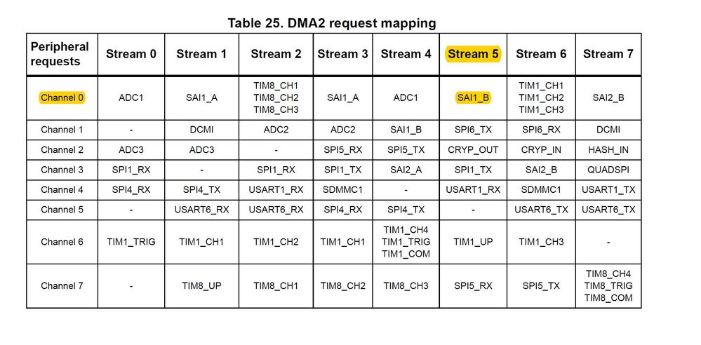

Go through the example and try to spot inconsistencies/places with fixed relationship to SAI1A. I took a glance into what may be a similar example for 'L4 and immediately spotted a fixed DMA channel assignment, for example.

for anyone else trying the same thing , I changed DMA to stream5 after seeing this DMA map
I'm using SAI1_B
hSaiDma.Init.Channel = DMA_CHANNEL_0;
add to stm32f7xx_it.c
void DMA2_Stream5_IRQHandler(void)
{ HAL_DMA_IRQHandler(SaiHandle.hdmatx);}SAI WORKING in SAI example on external pins.
