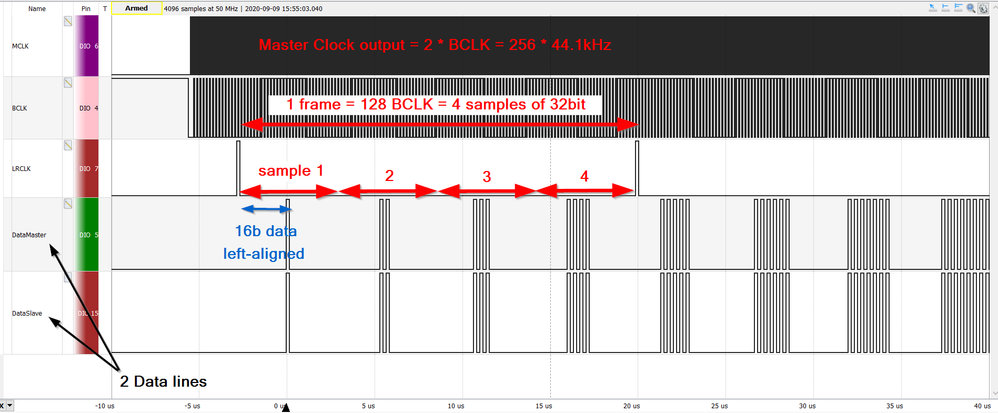

Here is my test setup:
The code:
// test data - dummy data very visual on the logic analyzer
static const uint16_t data[8] = { 0b1, 0b101, 0b10101, 0b1010101, 0b101010101, 0b10101010101, 0b1010101010101, 0b101010101010101 };
int main(void) {
HAL_SAI_Transmit_DMA(SAI_BlockSlave, (uint8_t*)data, 8); // slave first
HAL_SAI_Transmit_DMA(SAI_BlockMaster, (uint8_t*)data, 8);
while (1) {
if (buttonPressed) {
if (paused) {
HAL_SAI_DMAResume(SAI_BlockSlave); // slave first
HAL_SAI_DMAResume(SAI_BlockMaster);
else {
HAL_SAI_DMAPause(SAI_BlockMaster); // master first
HAL_SAI_DMAPause(SAI_BlockSlave);
}When I start the SAIs I get that:
So far so good, you can see both data lines are in sync, and also that the data is in the right place in the frame (since this is TDM, the DAC will send the samples to different outputs according to their position in the frame).

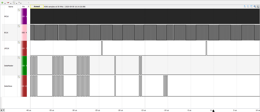

Then I press the button (calling HAL_SAI_DMAPause) and it does not (always) stop at the end of the frame, nor does the two data lines stop at the time (again: not always).

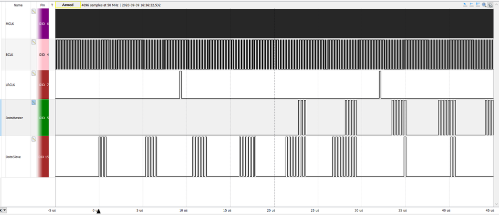

When I press again (calling HAL_SAI_DMAResume), and it seems the DMA/SAI make sure that the data within each frame is at its place, but since one SAI starts transmitting a bit before the other, then the other come one frame later sometimes, like here:

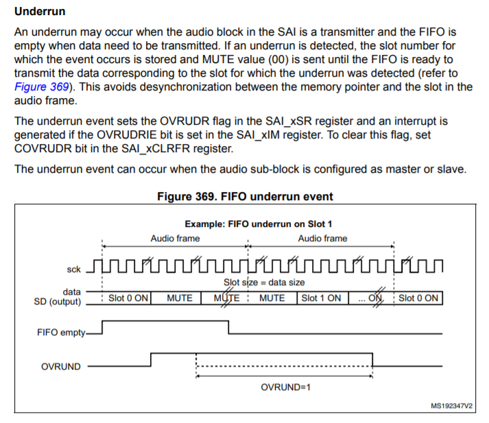

2020-09-09 8:13 AM
If I am not mistaken, here stopping the DMA simply means the FIFO is empty and is contantly in "underrun" until the DMA is resumed?
As the UM explains:
I guess I am doing something wrong here - I keep reading the UM, and even going through the registers it seems the only way to stop sending data from the FIFO (sending zeros if it is empty as shown in the screenshot above) is to disable the SAI with SAIEN=0. Problem is when I disable the master then the Master Clock stops being output.
