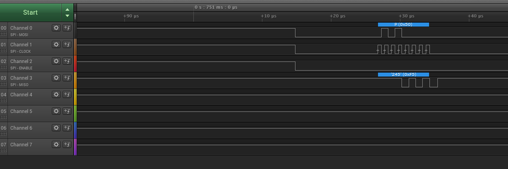

Observe the SCK pin using oscilloscope or logic analyzer.
2021-04-20 10:14 AM
Here is the clock, during the first send data,it produce normally, but when to clear the RXNE, it could not produce the SCK.

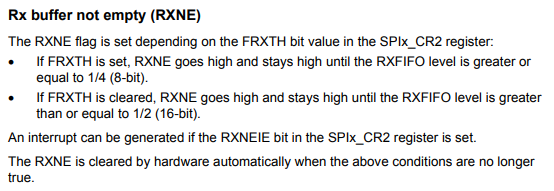

But, I suspect that the hardware automatically, clear the RXNE based on this:
But, Im not really understand what this means, can you explain it to me?

RXNE works as a watermark on the Rx FIFO. When a byte arrives, it is stored to FIFO, and it's "level" increments by 1; when your read out a byte from FIFO, it's "level" decrements by 1.
If FRXTH=1, if "level">=1, RXNE=1; if "level" < 1 (i.e. "level" == 0, FIFO empty), RXNE = 0.
If FRXTH=0, if "level" >=2, RXNE=1; if "level"<2 (i.e. there is zero or one byte in FIFO), RXNE=0.
You probably want to have FRXTH set to 1.

I have managed to SET the FRXTH bit. After the data is sent, the RXNE goes HIGH. But, after it execute next code line which is SPI_receiveData(), It automatically clear the RXNE. Is this means that the hardware clear the RXNE automatically?
If I want the RXNE stays HIGH, I do not understand what do you mean by the "level" If you could elaborate more, I am very appreciated.
