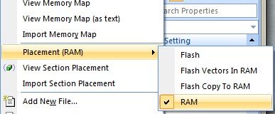

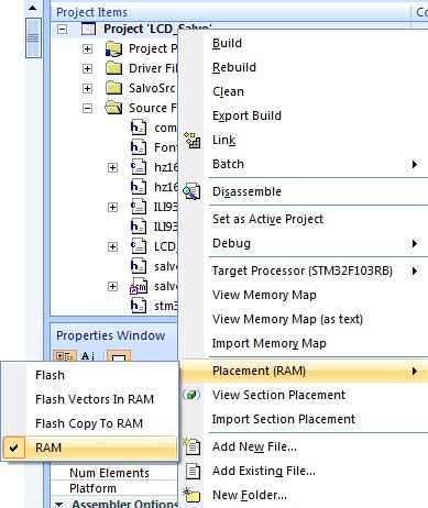

With Rowley Crossworks, it is as simple as making a selection from a drop-down menu.

Where do you find this menu? I must be blind! :pI'm using v2.1.2 on the Mac.I did a little research into this and see the flash placement and ram placement xml files in packages/targets/STM32 directory. But, isn't Crossworks supposed to access this info automatically?All I have in my projects' System Files folder is the STM32_Startup.s, STM32_Target.js, and thumb_crt0.s files. Are other files supposed to be in there?I don't see my MCU part name (STM32F407xx from STMF4Discovery board) in the STM32_Target.js file.

Right click on the active project in the ''Project Items'' Window.
