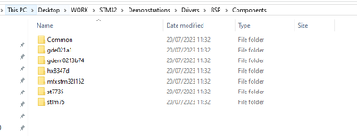

1. After importing project as per your initial instructions, I can see that there are many different drivers in the BSP->Components directory:

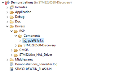

But when the I look at the project files from the STM32CubeIde I can only see gde021a1.c
Why I cannot see many other directories (such as st7735, Common and others)?
2. Additionally, I am a bit confused about why I can only see gde021a1.c file in my STM32CubeIDE project files (See screenshot above) and I cannot locate gde021a1.h file anywhere. If I look at the project files in the file explorer instead, I will find that gde021a1 directory contains both .c and .h files:

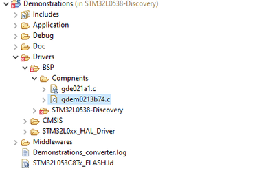

3. I have drag and dropped the gdem0213b74.c to my STM32CubeIDE project:
But I am not sure about this part: link it in the project structure.
And exclude from build the "gde021a1.c" file. Could you provide some instructions how to properly do this as I am getting the error:

Hello @LPetr.1
Perhaps you should take some time to familiarize yourself with the Eclipse environment and take a look at this link:
Regarding your first two questions, what you see in the STM32CubeIDE Project Explorer does not correspond to the physical structure of directories. In the Eclipse environment, there is a notion of Linked Resource for directories or files. As the demonstration project was converted from SW4STM32 to STM32CubeIDE, you can see the list of these Linked Resources in the following file:
"C:\Users\yourname\STM32Cube\Repository\STM32Cube_FW_L0_V1.12.2\Projects\32L0538DISCOVERY\Demonstrations\SW4STM32\STM32L0538-Discovery\.project"
You can read with your preffered advanced text editor (such as Notepad++ or SublimeText) and found all the source file (.c) linked with this project.
<linkedResources>
<link>
<name>Drivers/BSP/Compnents/gde021a1.c</name>
<type>1</type>
<location>PARENT-5-PROJECT_LOC/Drivers/BSP/Components/gde021a1/gde021a1.c</location>
</link>
These lines are specific for gde021a1.c but all c files of the project are listed. This is because the project was initially designed in this way.
For your third point, when you dragged and dropped the file gdem0213b74.c into the corresponding directory, Eclipse must have prompted you to either copy or link it. This is where you choose link it (and you should see a the file with an arrow icon in this case)
Finally, to exclude the other file gde021a1.c, you simply right-click on it, then select properties, C/C++ Build and check Exclude from build. This file will not be compiled.

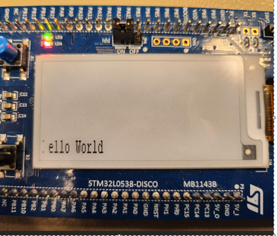

Regardless, I was able to get the display to work but it does not seem to be scaled to size properly:
As you can see text above cannot be fully displayed as it is out of display bounds. Perhaps this is because there are still some code related to the old revision and must be changed by hand for the new revision board? I havent had enough time to look at this but I will try to check why would it behave this way.
Anyways, thank you very much for all the help you provided.
2024-01-04 2:12 AM
Probably yes. Pictures from the thread I've linked above are similar. You've changed only the lowermost layer, i.e. the one which directly stores pixels to the display. The upper layer which actually produces the data does not take into account the changed display size (resolution) properly.

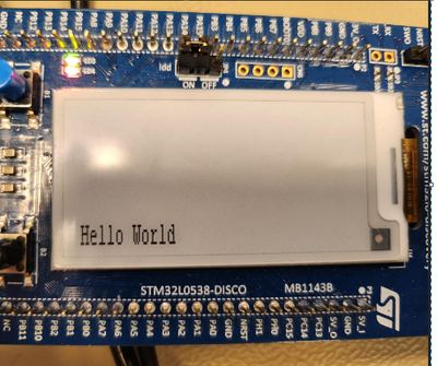

I have configured the Display window size (BSP_EPD_DrawImage) to be 72x172 and trying to Draw "Hello World" at cordinates (x=0, y=0).
BSP_EPD_SetFont(&Font16);
BSP_EPD_DrawImage(0, 0, 72, 172, Background_pic);
BSP_EPD_SetFont(&Font12);
BSP_EPD_DisplayStringAt(0, 0, (uint8_t*)"Hello World", LEFT_MODE);
BSP_EPD_RefreshDisplay();
The result:
But it works without any issues if I offset the text displayed by 10. For example, if I do:
BSP_EPD_DisplayStringAt(10, 0, (uint8_t*)"Hello World", LEFT_MODE);It will display nicely:
It seems that the display is not capable of displaying close to the edges
