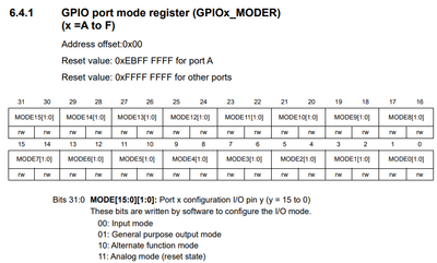

Hello @Najd_Elaoud,
One way is to visualize the GPIOx_MODER register. This register is responsible for configuring and storing the mode of each GPIO pin.
Hope that helps!

2025-07-23 2:57 AM
Thanks for the suggestion; using the MODER and OTYPER registers did the trick!
Here’s the code I used (based on your advice), and it works perfectly:
// Check PA12 mode (MODER12, bits 25:24)
uint32_t PA12_MODE = (GPIOA -> MODER & GPIO_MODER_MODE12) >> GPIO_MODER_MODE12_Pos;
// Check output type (OT12, bit 12)
uint32_t PA12_OUTPUT_TYPE = (GPIOA -> OTYPER & GPIO_OTYPER_OT12) >> GPIO_OTYPER_OT12_Pos;
if (PA12_MODE == 0X00) // Input mode
// USE ONLY WHEN PA12 IS SET AS INPUT
FUNCTION_1();
else if (PA12_MODE == 0X01 && PA12_OUTPUT_TYPE == 0X00) // Output mode (Push-Pull)
// USE ONLY WHEN PA12 IS SET AS OUTPUT_PP
FUNCTION_2();
}This lets me safely switch between the two functions based on the pin mode of PA12, just what I needed.
