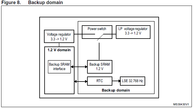

LSI isn't in the backup power domain, you must have an LSE for the RTC to work from VBAT.
2013-06-11 4:55 AM
5.1.2 Battery backup domain
Backup domain description
To retain the content of the RTC backup registers, backup SRAM, and supply the RTC when VDD is turned off, VBAT pin can be connected to an optional standby voltage supplied by a battery or by another source.
To allow the RTC to operate even when the main digital supply (VDD) is turned off, the VBAT pin powers the following blocks:
? The RTC
? The LSE oscillator
? The backup SRAM when the low power backup regulator is enabled
? PC13 to PC15 I/Os, plus PI8 I/O (when available)
The switch to the VBAT supply is controlled by the power-down reset embedded in the Reset block.
