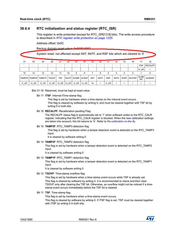

2020-04-19 7:39 AM
ALRAF/ALRBF are not affected by System reset, so unless you perform a Backup domain reset, they should remain set reflecting which alarm was invoked.
