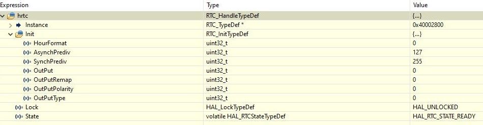

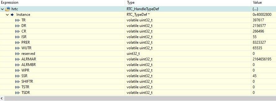

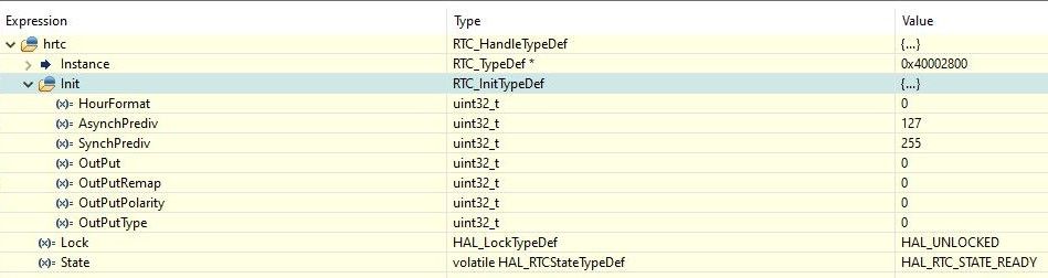

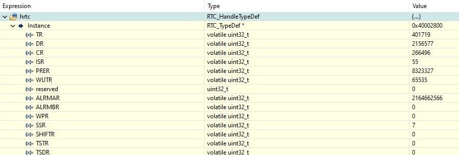

2020-08-20 11:27 PM
Fail:
success:
2020-08-21 12:52 AM
That was not the case. I check the RTC after setting the alarm and the TOD didn't roll over, but the alarm a interrupt still does not occur every minute.
2020-08-22 8:42 AM
The registers are essentially identical (next time you should present them in hexadecimal, decimal is mostly useless in microcontrolers settings). Namely. RTC_ISR.ALRAWF is set in both cases (while interrupt is enabled by RTC_CR.ALRAIE). So the problem is probably not there.
RTC alarms are EXTI18, so you should look at the EXTI registers and finally at the NVIC registers to find out why you don't have an interrupt.
Also, make sure you are indeed looking at the interrupt (e.g. by toggling a pin directly at the IRQ routine entry), and not just being tangled into some Cube/HAL nonsense tacked onto it.
