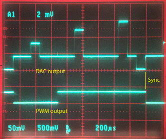

The solution i found now uses Tim6 to trigger the DAC (and its DMA, 15 samples) and Tim2 to generate the PWM signals. In order to synchronize DAC and PWM i am using the fourth channel of Tim2 in capture mode with Comparator2 to trigger on a feature in the DAC output waveform. So there is a wire from the DAC output pin to the comparator input pin. The capture interrupt handler implements error recovery in case one of the two timers or the DMA source address counter falls out of sync (primitive PLL).
